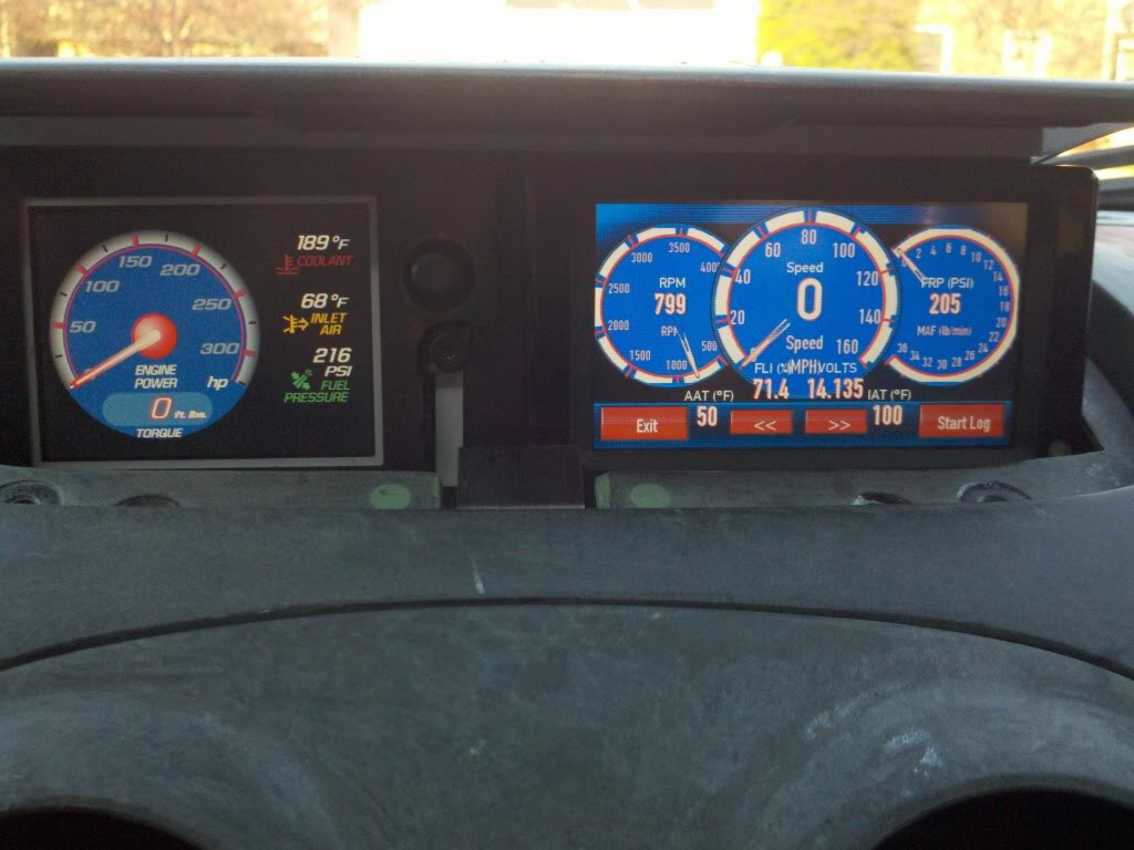

Hmmm very interesting..... How did you unplug yours?
Old Apr 21, 2011 | 05:00 AM
Father Azmodius's Avatar
Joined: 08-03-2009
Posts: 837
From: D.C., Md., Va. area
The RPD has a harness that can be unplugged from the vehicle harness and RPD. I removed the housing the RPD is in to replace it with the storage compartment on earlier models. My RPD is now mounted on a sliding rail so it and the Dashdaq move up and down, and once I finish the linear actuator install it will be remotely controlled.

I've heard it can be done, but I know nothing about it. Mine came with the car. I added the stock boost gauge and DashDaq.

To add the stock boost gauge to a car equipped with the RPD
1. Obtain stock gauge
2. plug it into the wiring harness that is under the A pillar cover
The issues are whether your car has the wiring harness and finding or fabbing an A pillar cover for the gauge. For 2009 both the RPD and the pillar gauge were offered, but if I remember correctly, 2010 was just the RPD so the wiring harness may not be there. When I was looking into this, GM wouldn't sell just the A pillar cover for the gauge and I didn't want to pay 360$ for it. I ended up modifying a spare cover (after totally effing up my original one)
