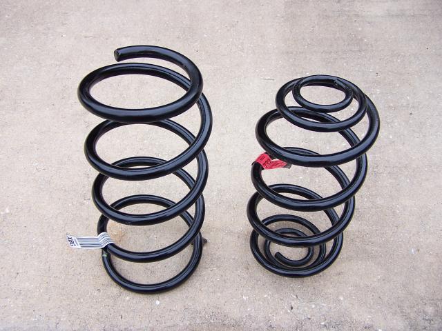

Here is a side by side against my factory springs
Front OEM Left, YYZ Right
Rear OEM Left, YYZ Right

Alright the YYZ V.5's are in and everything is back together. First Impressions on a quick ride out is fantastic. Their not bouncy and seem to handle really well. Definitely feels like a whole other car now compared to the B&G's And I can see why as well. The size difference was shocking, especially on the rears.
Rear Spring Comparison (Red = B&G, Blue = YYZ V.5)
Front Spring Comparison (Red = B&G, Blue = YYZ V.5)
I didn't have very many pics in stock form but heres one I did have from last year,
OEM Springs
B&G Springs
YYZ V.5
The rear does sit a tad higher which I thought was corrected in the later versions of the YYZ's but it may need a little more time to settle
