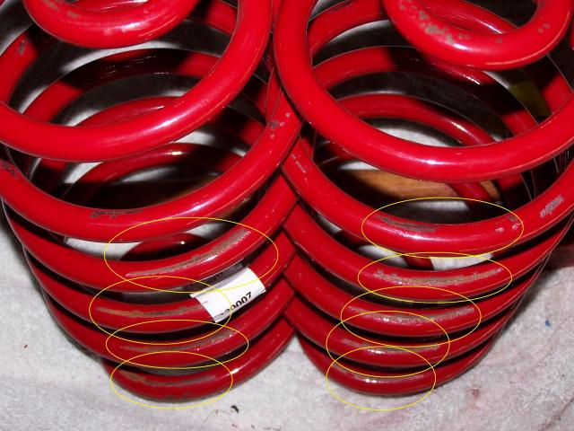

Posts: 11,723
Binding or hitting against each other is what my original rear Pedders did when I had them on my SS. Made for some clunking noises over any medium or larger bumps. Glad to get those off of my car.
Name:  Old Pedders rub spots.jpg
