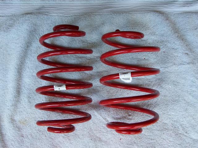

Not long. Pedders sent me a full replacement set. The rears they sent me were some kind of prototype. They work well with no noise. I think because they have one less coil wrap that leaves more coil spacing.
I still have the extra new front springs(Pedders didn't care if I returned the old ones, so I kept them).
Old version and prototype
Name:  Pedders Old and New.jpg
New rears
Name:  New installed Pedders 2.jpg

Hmm and to correct the issue they sent you springs that had more space between the coils, so they were not dead or touching or binding! ok that contradicts the touching coil rebound and compression theory of a dead coil check this out...
http://www.e90post.com/forums/showthread.php?t=609774
