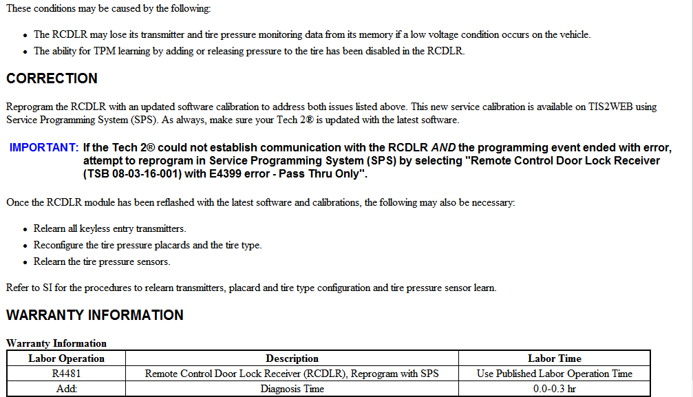

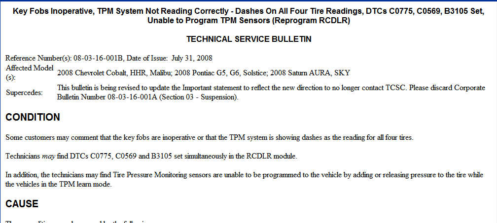

It should just need a new flash with updated firmware. Direct them to this TSB, it is specific to 2008 models.

ReRead the TSB. There is no hardware fault. Just software.
They misprogrammed 2008 RCDLR so that it lost its memory if the battery went completely dead for an extended time.
If you can convince them to look at it they can even get detailed directions from the "labor operation" code. Doubtful.
They are throwing parts at a known problem with a published correction.

If you can get them off of their lazy butts they have it in the GM corporate documentation. Also available in the TSB thread; post #55 here https://www.chevyhhr.net/forums/prob...d-23231/page6/
