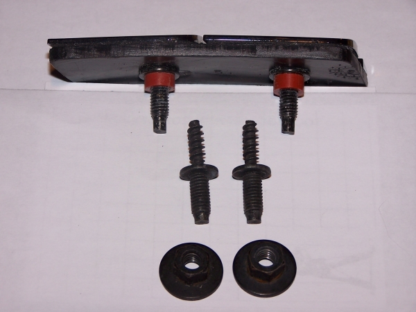

OK. Cut a plastic backing from some scrap I had.The extra 2 lag bolt/screws are the type I used on the backing shown. Ground off the excess end of the screws that poked through. I ground them flush on the emblem side. The red color rubber spacers take up the space in the grill mesh. The nuts shown are the ones I'm using for attachment.
The plastic backing is cut to match the outline border of the SS emblem.

Was it a side ss emblem you used or a back ss emblem you used
Did you screw the lags into the plastic and then cut off the extra before mounting the ss emblem?

Bigjack. If you would read all my posts,you would see earlier that I said it was the rear(smaller) emblem. That part # should show you that.
I cut the backing to correct size before the lag screws. Sanded the edges smooth. Then held the backing up to the grill so I could find the best mounting spot in relation to the openings in the grill. Marked the back side for screw locations. Inserted the lag screws at the marked centers(2 diamond shape marks from tracing through the grill) Or you could just measure center to center between the grill diamond openings.
Gound off flush, the excess parts of the screws that stuck through. Carefully used my bench grinder.
Lastly. I put the emblem on the backing plate. Then mounted it on the car.
