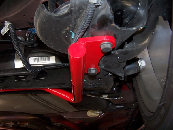

Originally Posted by TurboTechRacing
Does not change anything with adding a trailer hitch. You can still add your trailer hits/or keep it, whatever the case may be.
Yes but does the hitch and bar use the same holes? Or?
I have a Curt Hitch already on the HHR 1LT.
SF
Old Dec 29, 2012 | 06:16 PM
  #104
Posts: 11,721
The swaybar mounts to the lower side of the rear suspension. This is the rear
"swingarm" that cradles the rear springs. It moves up and down with suspension travel.
A trailer hitch is mounted to the stationary part of the unibody/framework. The trailer hitch mounting points won't be near the swaybar or it's mount point.
Old Dec 29, 2012 | 06:18 PM
  #105
Posts: 11,721
Another picture from a different angle.
Thanks for the reply and the Pic's
