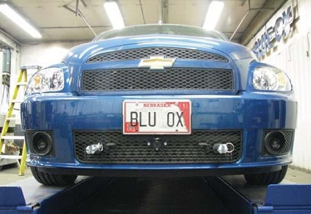

As far as base plates I like the blue ox. They make them for the SS also.
