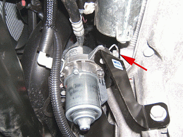

You can only see it from under the vehicle it is mounted to the block next to the oil pan on the passenger side of the vehicle. You would here it at start up too.
Attachment 4816
I didn't crawl under my car to see it but yes, you can very definitely hear it running at start up. I wanted to do some testing so this morning, after my car sat for almost 24 hrs, I started it up and timed how long the pump would run before driving off. Answer was just over 1 minute before it shut down. My normal routine so far has been to just start up, fasten my seat belt and then immediately back out the drive and motor down the hill. Works like a charm...in my 10 days of ownership, I've yet to experience any kind of funky brake action.
