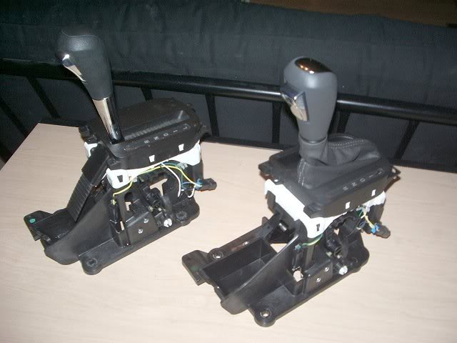

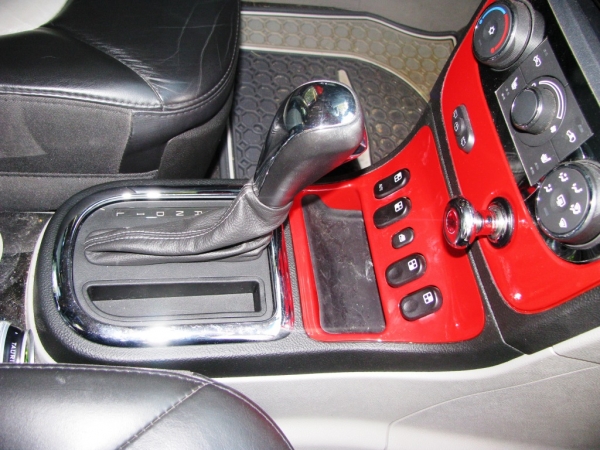

09 Shifter Assy works on 07
I got my 09 shifter today.
I also decided to replace the entire shifter instead of the easy way noted above.
Why?
When I took my shifter bezel off and found some spilled soda some food and some rust on the componets...oh and some chocolate.
All this time I thought I kept a pretty clean interrior.
To replace the entire shifter remove the 4 mounting nuts. Dissconect the drive cable (snaps off) remove the lighting plug wire.
** Note the mounting bolts will drop down flush from the shifter when you remove the nuts. Youll need a long screw driver to get under the heads and push them back up to get the nuts back on.**
The only thing I had to transfer over from the old unit was the chrome bezel.
BTW: The iPhone fits nice in the added slot next to the shifter.
Cheers !
