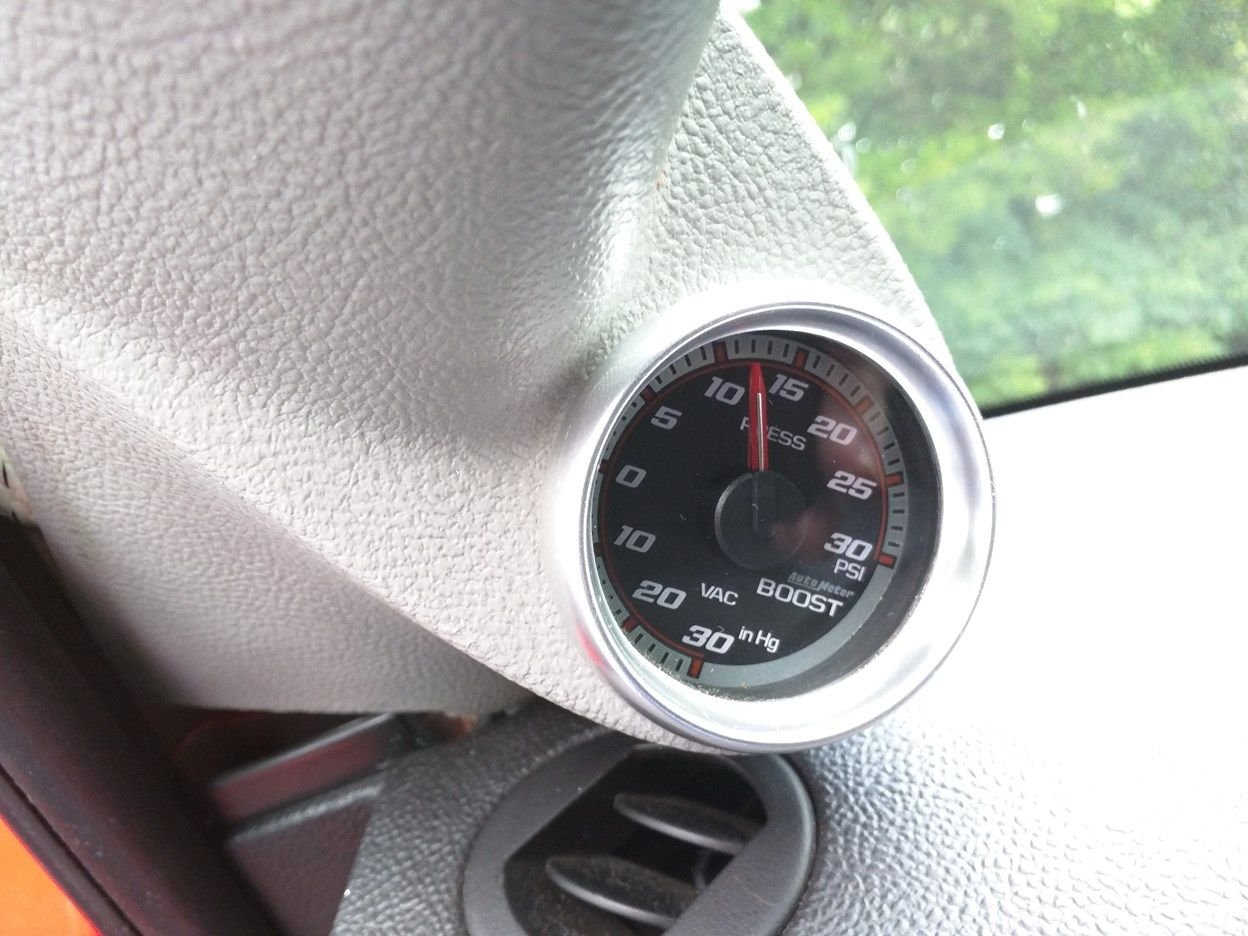

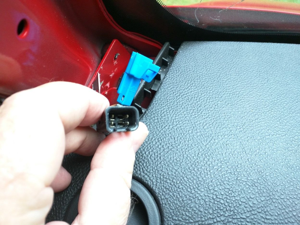

HELP!
I got my gauge from HHRSS330 (thanks again!) and mounted it in the pillar and went to install and came upon a little snag.
Both the connector that comes from the gauge and the connector coming up out of the A pillar area are identical.
Each has 4 vertical male posts and 4 horizontal female slots and they do NOT plug into each other.
There is so little slack on the cables coming from the car that hard-wiring it would be a major pain.
Anyone have any ideas? Am I just missing a "male to male" adapter or something?
Old Jun 9, 2018 | 04:57 PM
  #30
Posts: 26,484
Could go to a GM dealer parts department and get the female side.
I'm having a hard time finding the connector, but post time is in 50 minutes. Is there a number on either one?
