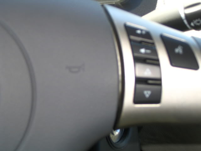

just added controls but have a problem
ok so I just added the radio controls but now there is gap on that side between the controls and the airbag. Any one else have this issue and if so how did you fix it?

Me too...
A low tech solution for me was to partially insert the horn / airbag pins into the holes and yank the unit to the right a few times ....gently...as I reinstalled same.

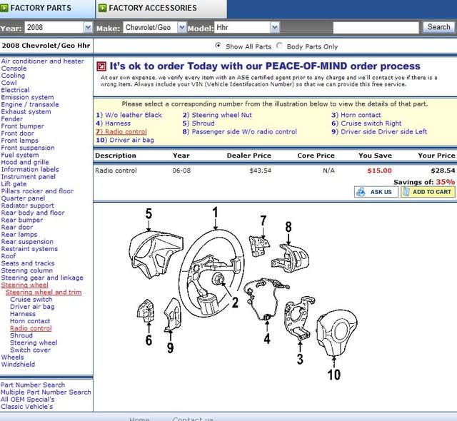

Check with member Cajun...he has an 08 and did this mod. Sounds to me like the dealer is blowing smoke up your skirt and trying to sell you a new steering wheel.
Try this link HERE.

Here is a contact at www.parts.com
This guy helped me to order the 3 parts I needed.
Raised Button Switch
Switch Cover (tell him what color....Charcoal or Silver)
Wiring Harness (you will need to swap wires for it to work in a 2008)
Contact:
Brad England
1-800-779-3447
Basically, you want to order the parts for a 2007, and swap the positions
of the wires on the harness to accomodate the cruise and radio controls.
Swap the cruise wires to match the colors currently on your 08....and swap
wires 1 and 4 on the radio button side. (the 2 outside wires)
I used a dental pick to slide the wires out of the connector.
Cajun
