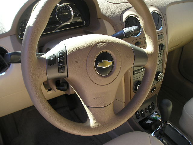

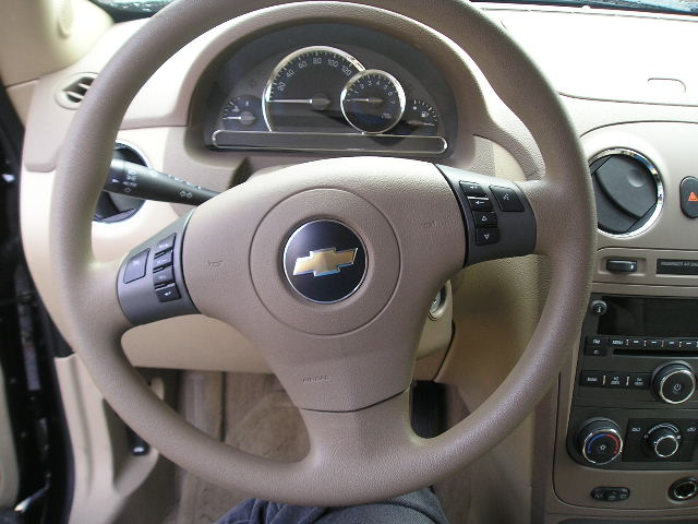

Parts came in fast, and went in fast. Great mod.......here's before & after...
