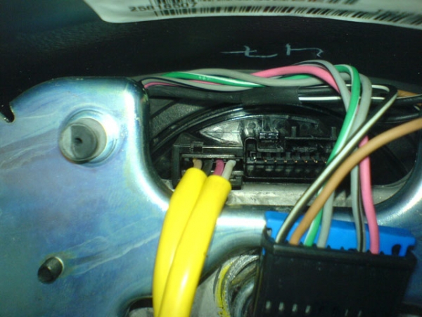

While test driving it, I left the fuse out. I got an airbag warning that the airbag needed service. As I turned the steering wheel, I could clicking noise, like a piece of plastic was not seated right. The I spied a blue piece of plastic on the passenger-side fkloorboard, it was a retainer to keep the harness together. I took the car up to speed (for me that's about 70 mph), hit the Cruise Control - nothing, nada, nix, nien. On the plus side, the left hand switch that cycles through options worked, as did the reset button below it. All the music buttons worked, including channel up/down, nolume up/down and the mute/OnStar button.
Now, what happened to the cruise? Possible that it was broken in the accident (it's from a dismantle shop) although it clicks down and stays down until you click it again, then it releases. I'm going to have to pull everything apart again to put the blue retainer on, and check about the plastic scraping noise, maybe I pinched the cruise wire? This may be a very bad day for me.

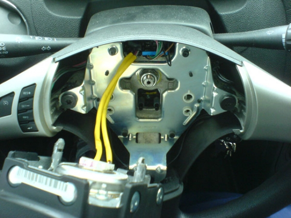

Wow, an update. Went out, showed her the gun, took off the airbag and pulled the wheel (less than 3 minutes). The blue clip didn't work, because it was slotted for the Cruise Control wires only, nothing for the Audio buttons. Anyway, I fiddled with the connectors, thinking I had a loose wire and that was why the cruse button didn't work. Put everything back together, now nothing works. Did I blow a fuse? If so, where is it?
Wow, sorry to hear you are having problems. If you need any pics of how its supposed to look, I have a few.
It sounds like the blue plastic piece is the retainer from the main plug going into the steering column. Is there one installed there now? It seems to hold all the wires in, so if thats missing it may be causing problems.
