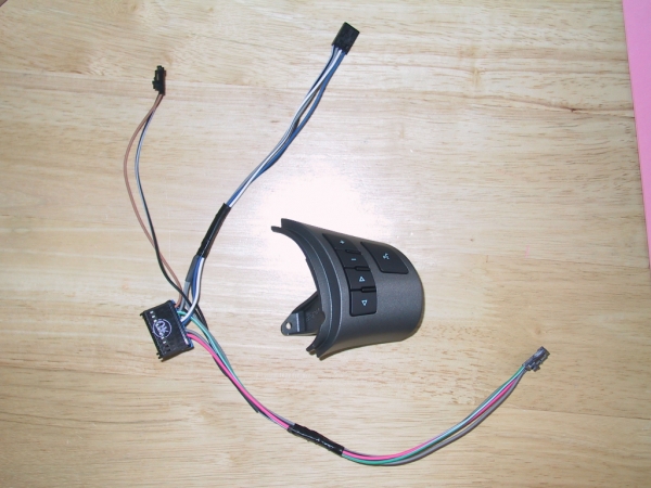

Here's a pic of the harness.
Even better! I love the internet!

Originally Posted by dnvachon
... getting the wire with the plug for the cruise control on it out was a PITA. If I would have just cut the wires it would have only taken a minute but I messed with that plug till I got it out. The original wiring was routed under the metal thing that holds the steering wheel on and there was hardly enough room to get that plug threw.. once I got it out I just plugged the new harness in but did not run the wires like they did from the factory.
I'm in the middle of puting mine in right now. I second these comments - what a pain, I thought the stupid connector was never going to come out (EDIT: meaning being able to pull it out from behind the steering wheel assembly) on the cruise control side. Looked like my steering wheel was undergoing surgery, drop light and a tool in each had to pry the wire bundle from the plastic clips back there. And forget about re-routing the same way. If you don't want to keep the old connector, CUT IT!
Edit: It's in and working now, I love it. Neighbors probably wondering why I was honking my horn in the garage.
