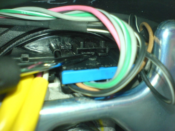

Yep. you're right. I was trying to put it in backwards. Now that I see where the blue retainer goes, I try again this morning. By the way, how do you get the plug to separate? Hopefully, that is all it was. I keep everyone updated.

Are you asking how to get the plug out? I used a very small screwdriver to pry up the small retainer clip while pulling the plug.

Thanks. I got it out the first time, but was unsuccessful last night. I'll try again this afternoon. I'm just paranoid about ripping something that wont be fixable.

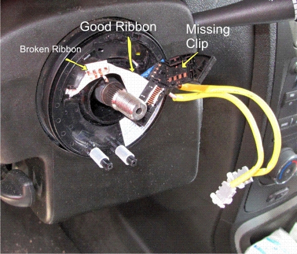

OK, found my problem. Obviously, it was my fault, as small plastic parts fell from the clock spring when the steering wheel came off. I tore one ribbon off and lost a small clip that held it on. I will have to buy another unit, complete. I hope that I can get it from Parts Direct. I'll call them later. Here is a photo of the damage.

Ouch, thats too bad. Hope you get it worked out.

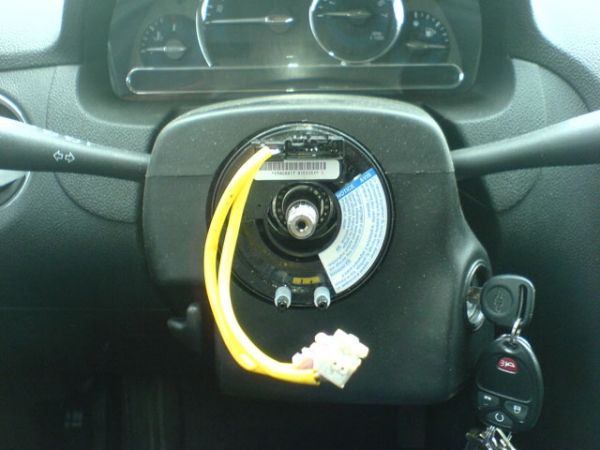

This is what mine looked like after unclipping the plugs and removing the wheel.
Looks like you popped off the front cover maybe?

I just finished doing the upgrade the "easy way"..!
I was going to order the module from GM but found a whole leather wheel from Ebay for a great price..$40.00 plus $25.00 shipping.
The only white knuckle part was pulling the old wheel off and figuring out that I had to disconnect the airbag wires right at the bag not the clock spring.
I couldn't find the GM special tool so I had to improvise with a gear puller that I had, there were a few beads of sweat on my forehead as I had to apply a lot more torque to the puller than I thought.....the resulting bang was a tense moment but all was good the wheel popped right off.
Now that I have done this once, with the right tools it would be a 15 min job including the disconnecting and reconnecting of the battery and a 5 min wait to drain voltage....just in case..!!
