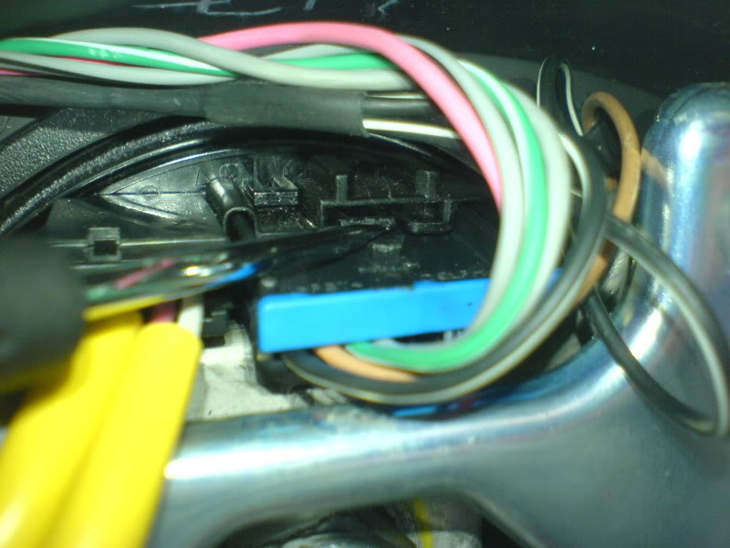

Is the plug in step 9 the middle one with the blue plastic cover/retainer? I'm trying to figure out how to remove it without destroying it. The one I pulled at the junkyard almost came out in pieces, I need one of them intact...

Does this pic help?
Gotta lift the retaining clip with a sharp tool, but its kinda inside the outer housing.
