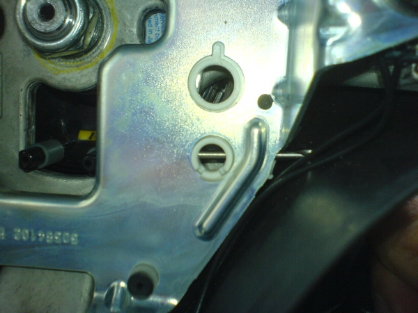

It can be tricky to find the retainer clip the first time. You can see it if you shine a light in there and look hard. Its like a shiny wire running vertically.
I can post the pics I have if you want.

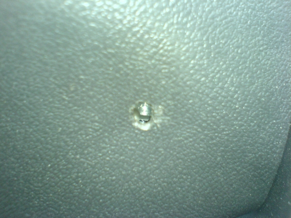

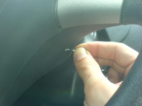

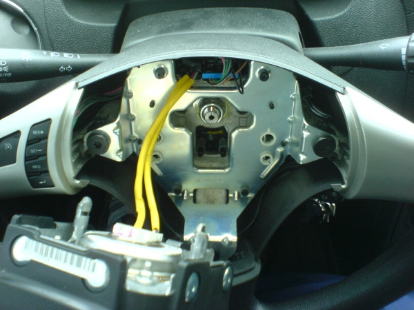

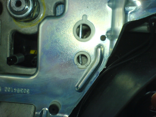

Ok here ya go, this is a pic looking in the little hole on the steering wheel, you need to press against the metal retainer by poking something straight in there. I used a drill bit. If you angle it too far forward or back you wont hit anything.
And heres what happens inside as you do it, you need to push the retainer out of the way to disengage it from the slotted posts on the airbag.
