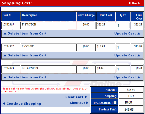

Update... P&G won't be cheaper after all They too only have the superceded part.

Those look like the same part numbers...be back in a second...I did a print page and am uploading the image. Or do things change when you go thru checkout...I didn't go that far.
BTW...thanks for the link wackaloon

The F-Switch was originally part# 15244413 and was superceded by 15842365.
When I tried ordering the original part #, it came back as superceded with the higher price.
