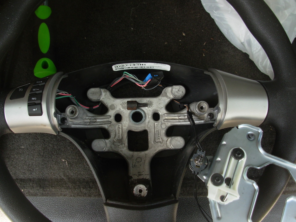

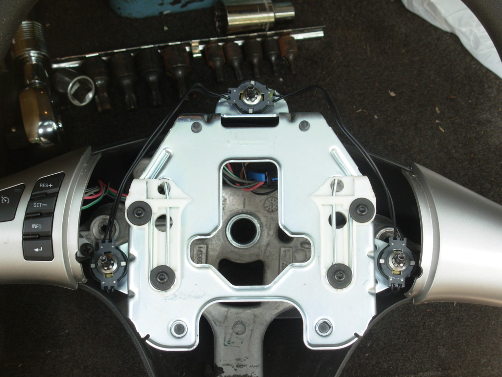

Ok, I screwed something up. My horn no longer works.. *sigh*
I think I pulled out the black wires for the horn. Anyone have pic of the wires behind the airbag that show the wiring for the horn?
Old May 5, 2013 | 03:53 PM
  #750
JerseyJames's Avatar
Joined: 08-24-2012
Posts: 177
From: State of Confusion, U.S.A.
Post horn not working
this be of any help?
