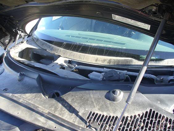

Adding some pictures regarding this patch.
I know some went to the dealership for a new patch, but I went the way of some others and made my own metal patch.
After following the earlier steps provided in this thread, I moved the plastic cover down on top of the air filter. I did not disconnect the washer fluid line:
The old, torn, and poorly made patch. Ready for the garbage :
This is the view inside the hole. The plastic piece at the bottom has a small area to drain any water that gets inside. There are also two pieces that you'll find under each front wheelwell for it to drain. However all of them were heavily clogged with debris. You can also see the entry for the cabin air filter which is now the final piece to be changed:
This is the new piece of metal I placed on top. I cut it to match and used gasket maker/sealer. Got a regular tube of it from Canadian Tire for ~$6.00 and a sheet of metal from Rona for $2.50. Pretty close in colour to the factory black so that's an added bonus. Obviously, it is will be needed to clear the area before sealing, since it will be rather dirty.
Took some old farm tools and placed it on top of the patch waiting for it to set. Gave it roughly 3 hrs while I had supper and visited with my Grandpa. After that had set I put a top layer of sealant around the path so it is fully locked down from both ends and made a drill hole for the one screw that would otherwise be covered but did not take pictures of that.
Happy HHR with the luxury of a working fan. It was 35 Celsius (95 F) so it was much appreciated!
