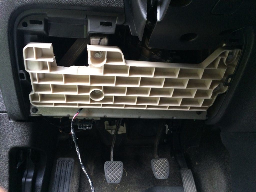

I considered a lot of different spots, into the headliner, on top or in front of the RPD, various spots on the dash or console, into the visor... after a lot if brainstorming, I found a spot I really liked. Under the steering wheel into the knee-panel.
Had to start out by cutting out a small section of the white panel (with how little was removed and what i have added, not worried about integrity during a collision).

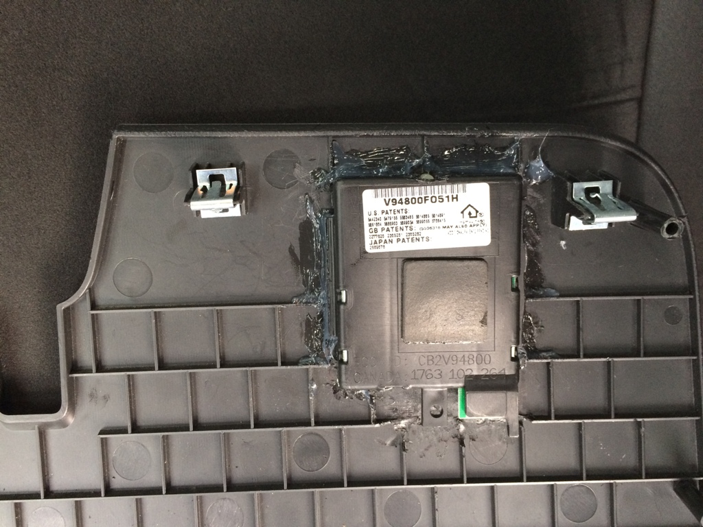

Sanded down the backside of the black panel so that the homelink could sit more flush. Siliconed the homelink housing and the faceplate to the black panel; since the panel was too thick to allow the buttons to make contact with the switches, I had to cut some small aluminum cylinders to "extend" the buttons and make contact with the switches again. The spacers are sandwiched in between the housing and the faceplate and held captive in there.

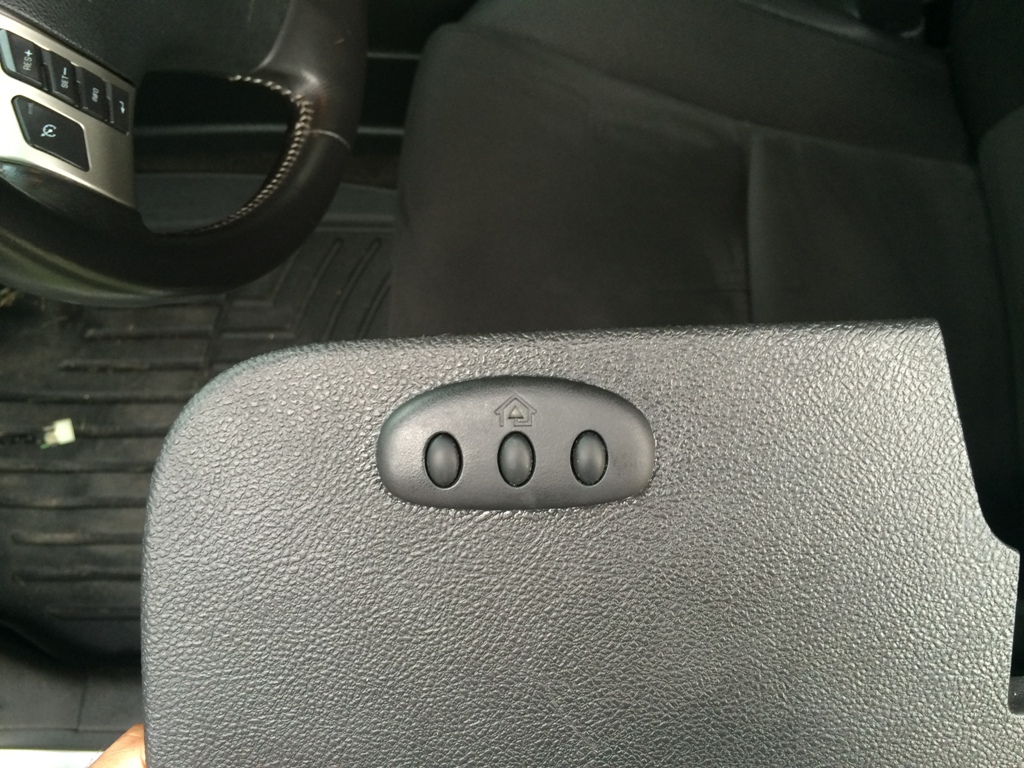

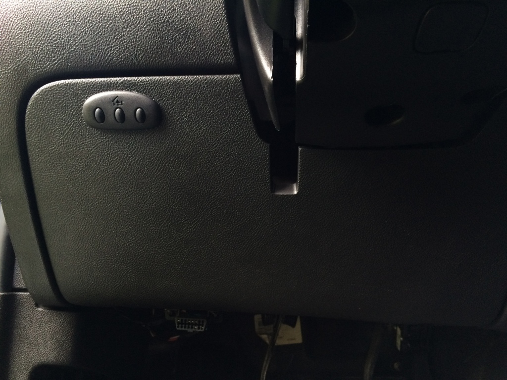

Final product:
I was worried about range in this location, but it works great, further then my regular garage door opener.

Happy to help. The extension pieces are made from an aluminum [round] rod that I had laying around; basically I just cut 3 small pieces off and used them in between the rubber part of the buttons and the switches inside the housing.... there is a little "well" in the housing that they slide into and stay inside of. The length of those cylinders depends on how much material you are stuffing between the housing and the faceplate, I had to fine tune it... if the cylinders were too long, the buttons stay pressed all the time, too short and i wouldn't be able to press the switches. I will have to try and take some pictures on a spare module later, that would be much more clear than a wall of text. In my case, the thickness of the black panel was such that the faceplate could no longer snap into the housing.... with the setup i created, it doesn't snap into the black panel either (the press fit studs on the faceplate break apart after just a few uses anyway, so probably not worth the hassle to go that route) that's why the both the housing and the faceplate are siliconed to the black panel.

I got this one a long time ago, I believe it came from a Lincoln Mark VIII??? The black faceplates were a little harder for me to find at my local u-pull-it joint, but the Mark VIII had them i belive; they are easy to paint if you can only find another color. Just needs 12V const and ground, I tapped a fused line into my dome light circuit for 12V const, its a very small load, and used a bolt near the interior fusebox as a ground.
