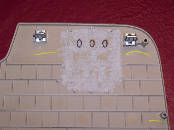

Here is the prep for the back of the dash panel. You need to grind down the ridges on the back side.

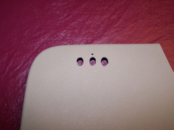

Here are the oval holes drilled out. I used the homelink trim plate to mark it out. I did not use the trim plate on the front like armarv12 did on his install (even though I like the look better) because I only had a gray one, rather than a tan/brown trim plate. But on the plus side, you don't need to worry about the buttons being long enough to reach by not using the trim plate.

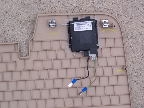

Gluing the unit to the backside of the dash. I used silicone, that way it could be removed if necessary down the road.

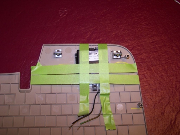

Here it is ready to install. I drilled a couple holes in the clip areas and put an extra support wire on the back. Not sure if that's necessary, more than likely overkill, lol, but not much room for silicone near the top due to the buttons.

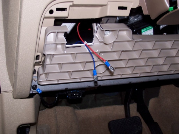

Dash prep, you need to remove some of the dash backer material to allow for the homelink unit. Be careful NOT to put the unit too high, or you'll need to trim a little from the upper dash material (which I had to do at the very end). Run a power wire over to you fuse box, and another one for a ground (I used that mounting screw in the lower left corner in the metal dash sub-frame).

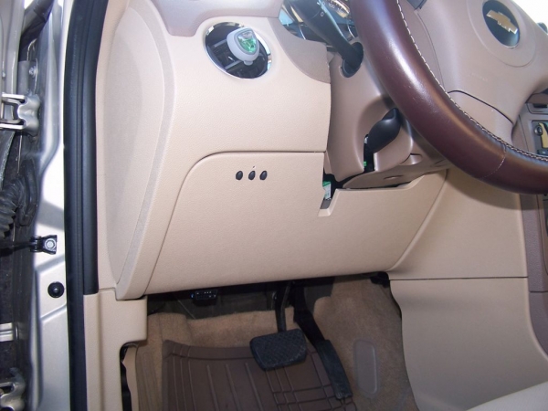

Final results.
