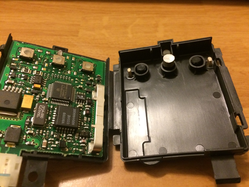

[QUOTE=amarv12;787295]Happy to help. The extension pieces are made from an aluminum [round] rod that I had laying around; basically I just cut 3 small pieces off and used them in between the rubber part of the buttons and the switches inside the housing.... there is a little "well" in the housing that they slide into and stay inside of. The length of those cylinders depends on how much material you are stuffing between the housing and the faceplate, I had to fine tune it... if the cylinders were too long, the buttons stay pressed all the time, too short and i wouldn't be able to press the switches. I will have to try and take some pictures on a spare module later, that would be much more clear than a wall of text. In my case, the thickness of the black panel was such that the faceplate could no longer snap into the housing.... with the setup i created, it doesn't snap into the black panel either (the press fit studs on the faceplate break apart after just a few uses anyway, so probably not worth the hassle to go that route) that's why the both the housing and the faceplate are siliconed to the black panel.

Here is a picture of one of the extra "extension" pieces i cut sitting on top of one of the rubber buttons:
In the above picture the faceplate is snapped in place, but when you try to sandwich something thicker between the housing and the faceplate, the rubber doesn't make it out of those "wells," so the aluminum rods perfectly fill that gap.

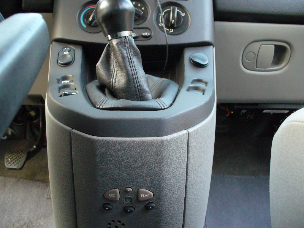

...As an alternative, here is how I mounted a homelink in my old VUE:
Sculped the panel out with my dremel and used a torch to flame polish the edges of the plastic. Just another alternative if the panel thickness is right.

That looks really, really nice... very "factory" appearance. You did an amazing job, even getting those "oval" button holes matched up so well, wow is about all I can say!

I used the original faceplate as a template for cutting those holes, helped a lot.
