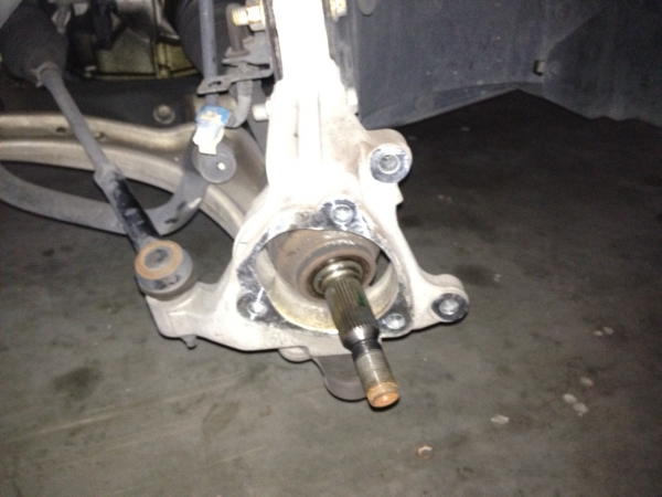

ok, here it is again... with pics!
starting place- took off the calipers (14mm) and rotors to get to the real problem...dont forget to unplug the ABS sensor
https://www.chevyhhr.net/gallery/fil...0/hubstart.JPG
here is the trouble I first ran into... the axle nut (30mm) is on there good... 155ft/lbs How do I get it off with the wheel and brakes already off? I looked all over the shop and found some angle iron I had laying around and bolted it on to the lugs (it didnt matter because the new hubs had new lugs... https://www.chevyhhr.net/gallery/fil.../hubremove.JPG
then its 3 15mm bolts to get the whole thing off...
https://www.chevyhhr.net/gallery/fil...5/0/huboff.JPG
Keep an eye on how the brake shield is oriented ( took me a second try after it was wrong).
Reinstall- I used blue lock-tite in everything... 85lbs on calipers and hub bolts, 155 on axle nut Viola!
https://www.chevyhhr.net/gallery/fil.../0/hubdone.JPG
