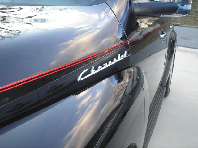

The Result on each door looks like this:
