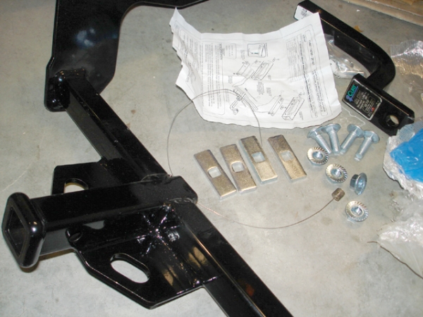

The weather was a bit warmer last night so rather than sitting around watching TV I decided to tackle the hitch installation. I pulled the hitch out of the box & here's all the parts & pieces:
Close-up of the parts:
The steel is heavy-duty. You can see the hole (slot) for the bolts to be installed later:

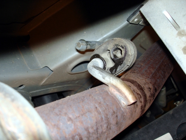

There are rubber muffler hangers (isolators) that need to be removed so the muffler can hang down. You need to drop the muffler to gain clearance to mount the hitch.
They suggest spraying a lubricant on the rubber to help them slide off. I didn't have any WD-40 so I used motocross chain lube
Here is the hanger in front of the muffler. There is one more hanger forward of this location:
Here is the hanger at the back of the muffler:
I had three isolators loose & the muffler still wasn't hanging down very much. Hmmm, maybe my muffler can't hang? I started looking for one more hanger & I found it here on the left of the muffler:
Finally the muffler is free to hang:

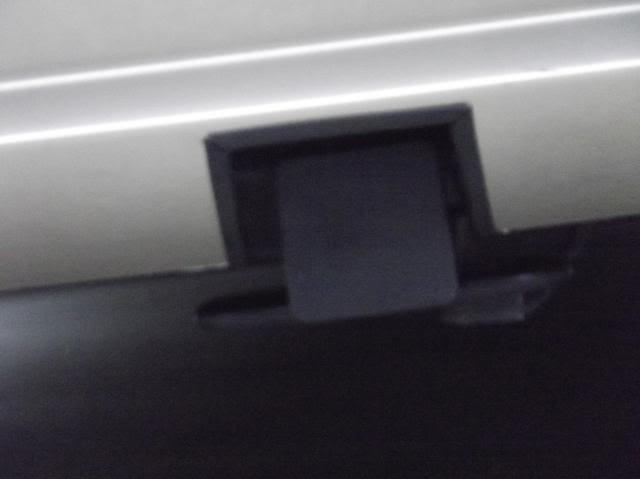

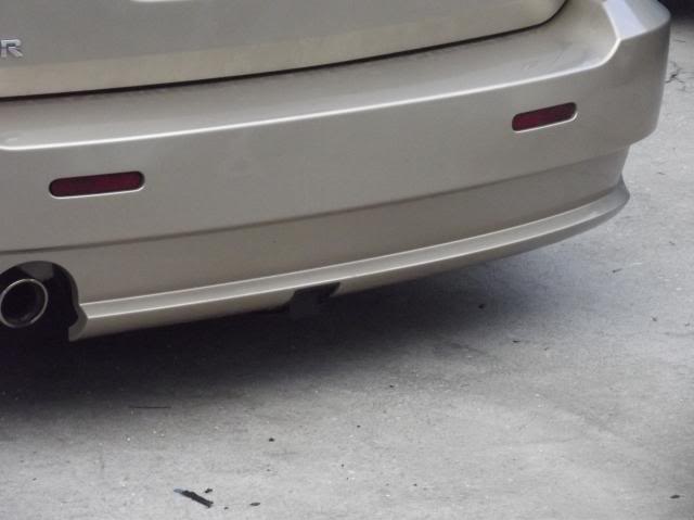

When I put the SS bumper on I had to notch it for the hitch then trimmed the cut with door edge molding.You really don't notice that I have a hitch till I put on the draw bar.
