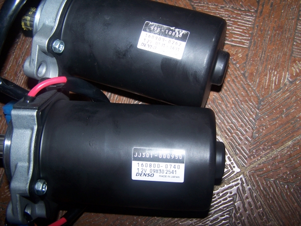

Originally Posted by R CA HHR
Well that was a pretty easy replacement. I just did it in about an hour in 20degree weather.
Only problem is.....It still doesnt work.
Is there a need to reset a code or anything?
The part numbers were different on my new motor, but the dealer said it was updated or superceded.
Here are pics of the difference, its pretty much just the conical whatever it is at the base of the shaft, and the part numbers which I called to verify was correct with my vin#.
The part number for the one I just bought is 19257875, not the 2099????? number the OP shows in his pics.
The pic looks like the sizes are different, but in reality they are the same and I did install the O-ring and lube the shaft up good before I put it in.
As I was typing I realized that conical piece may still be on the car, but the new one slid right in like butter so I dont know.
Any Ideas would be awesome,
thanks
part number change....
http://www.gmpartsgiant.com/parts/gm...-20995579.html
http://www.gmpartseast.com/parts/gm-...motor-kit.html
