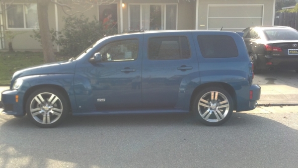

So I took her home Friday and already put 500 miles on her.
Couple of questions if you guys don't mind.
1. Car has the PDIC and one of the screens has A/F ratio. Is this a wide band or narrow band. I will be amazed if it is a wide band but if it is I know which display will always be on. Either A/F Or the one with Knock Retard. STOCK IS WIDEBAND! AWESOME. SEARCH BUTTON REALLY DOES WORK!
2. Tunes: I have heard amazing things about Trifecta. I would like to keep my warranty and have not been able to find the following. If I get their tune that I put in myself with my laptop can I switch back to the stock tune and have it pass the GM techs as if the computer never been messed with. If not Sounds like stage 1 is for me. Any recommendations for shops on the peninsula in CA to do the stage 1?
Thanks for any help.
