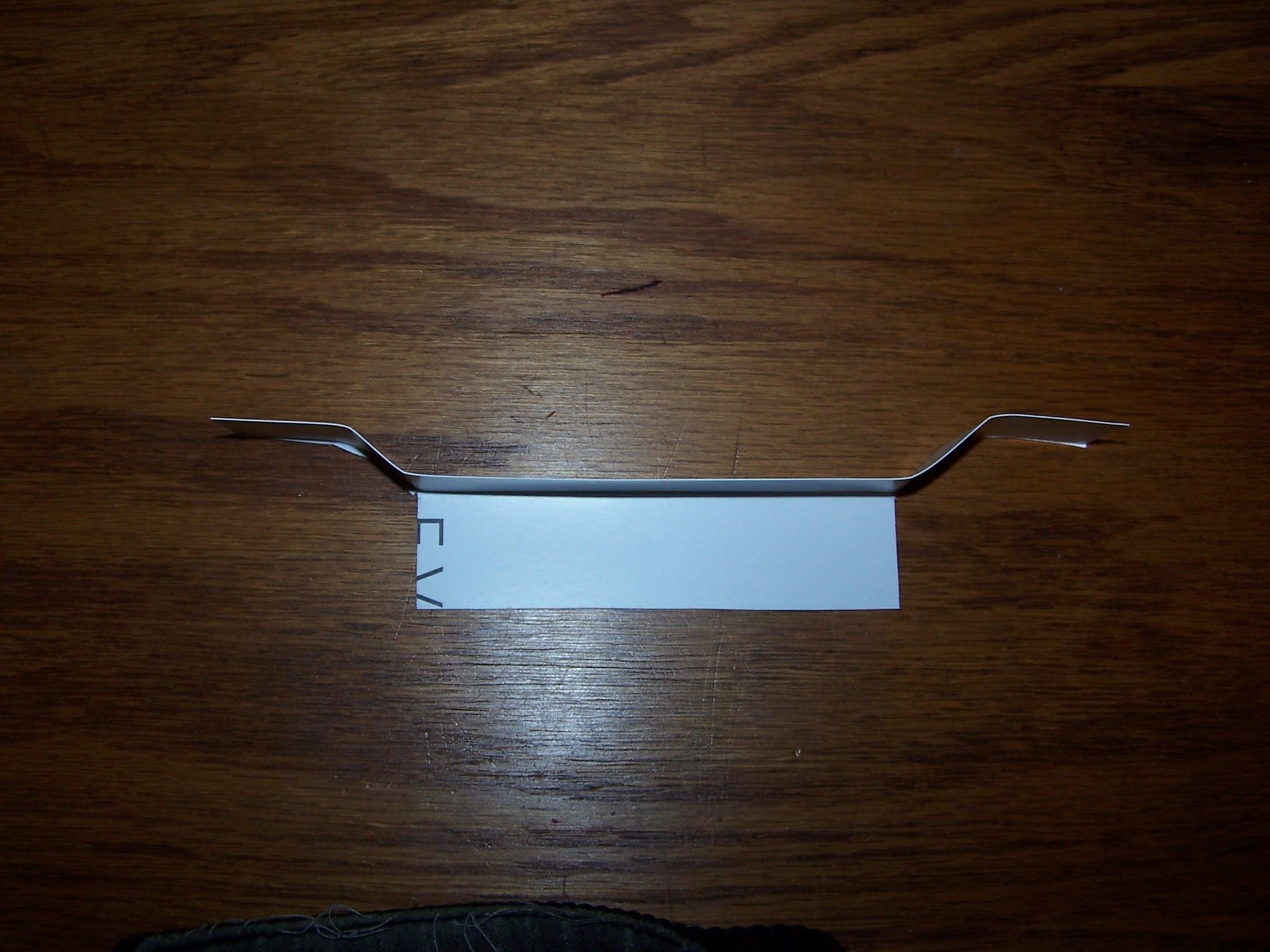

Looks good. What I used was a piece of L bar. Left the "L" part in the middle and and cut it off the sides where I needed to make the bends. I was thinking the bar would be more rigid and straight in the middle. The trade off is reduced space under the seat. If you have back seat passengers, I think it would limit where they could put their feet.
Here's a mock up with paper to show what I'm trying to explain.

I think since I've had the car the only person that's been in the back is my son, he's almost 4 and sits behind the passenger side. This is my DD and the interior kind of takes a beating from me working in the elements. Try to keep it halfway clean but it's quite a chore. Thanks for your guidance on this subject. If I hadn't gotten your pics, don't think I ever would have tried this. Will get some pics of final piece before paint/install and post them up on this thread. Thanks again George 👍
Hardest part was trying to keep the bottom wide enough for the seat rails to fit, bends had to be fairly extreme. That's why I was thinking of going to 1/4" steel plate instead of 1"2.

Yeah. Know what you mean about getting it to fit. Not sure how many times I did a test fit and had to tweak it. Over and over. Making a custom part is a lot of trial and error. I seemed to have had a lot more errors than I should have.
But the finished product was just what I wanted.
