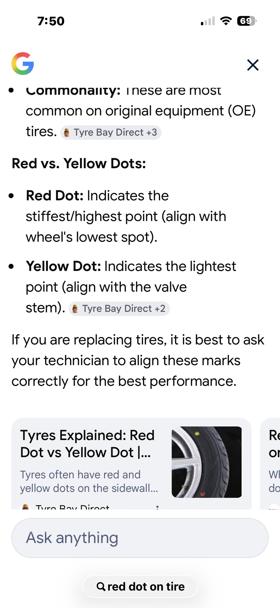

The yellow dot is supposed to line up with the valve stem.. It marks the lightest spot on the tire.
https://encrypted-vtbn1.gstatic.com/...MKbMs0UQm-gW0f

The yellow or the red? I always forget!
