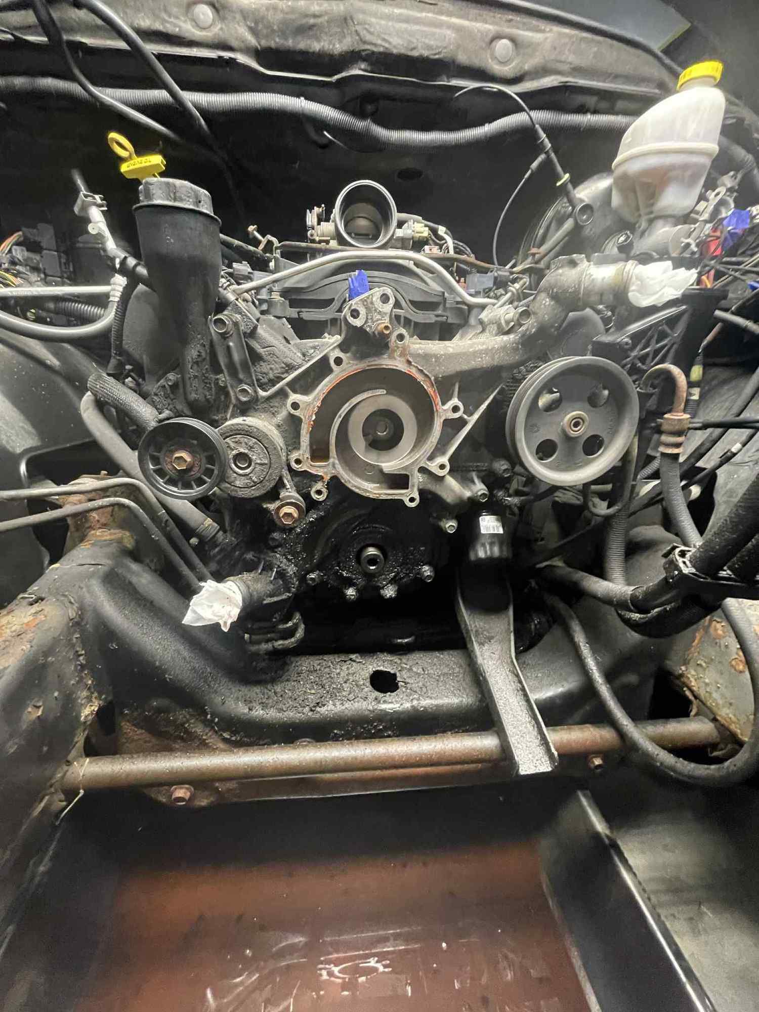

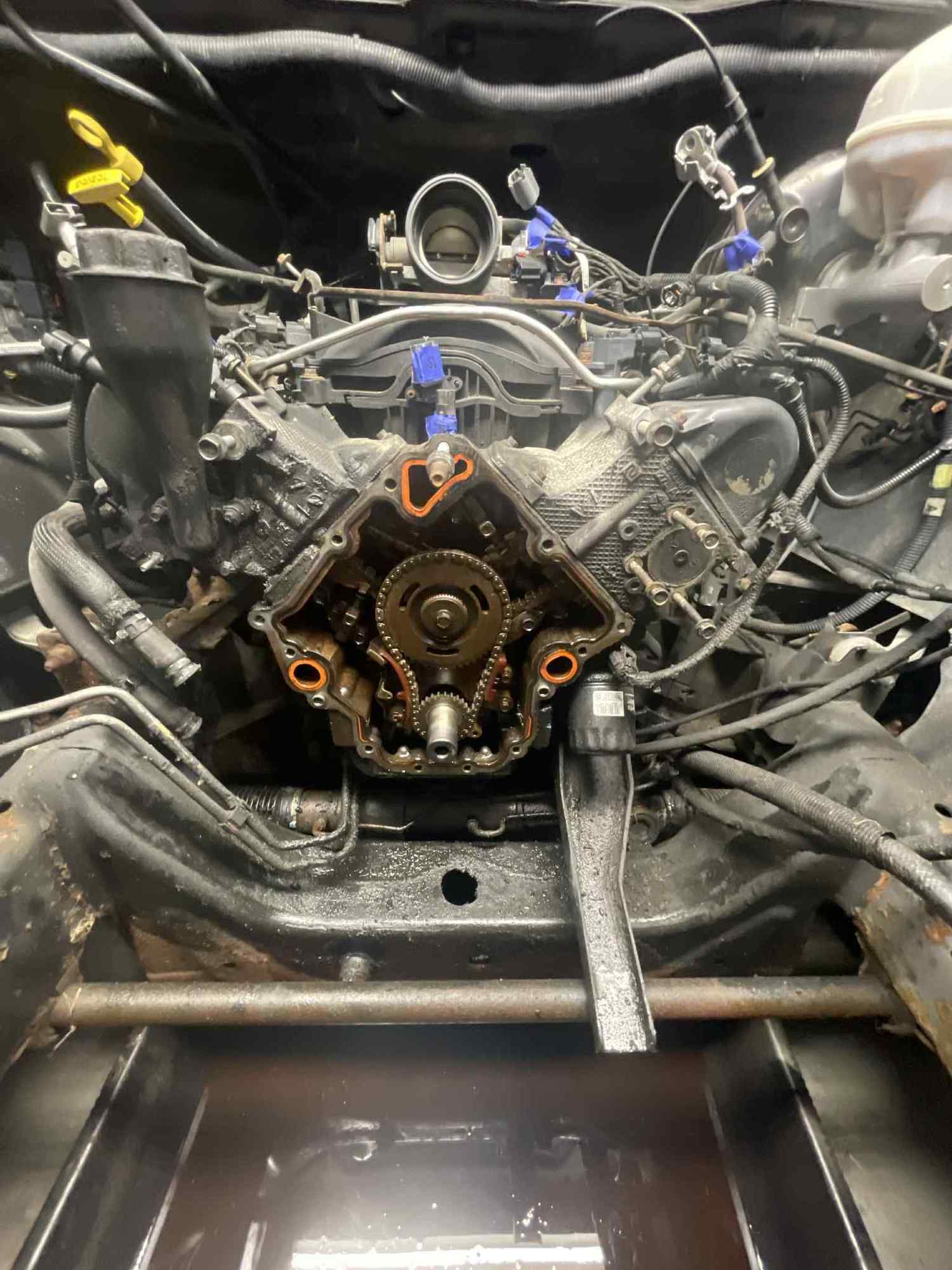

Yep, just taking it easy and slow, paying attention to details as it has overhead cams/3 timing chains simular to the HHR....
Taking it easy a few days before removing manifolds and heads...

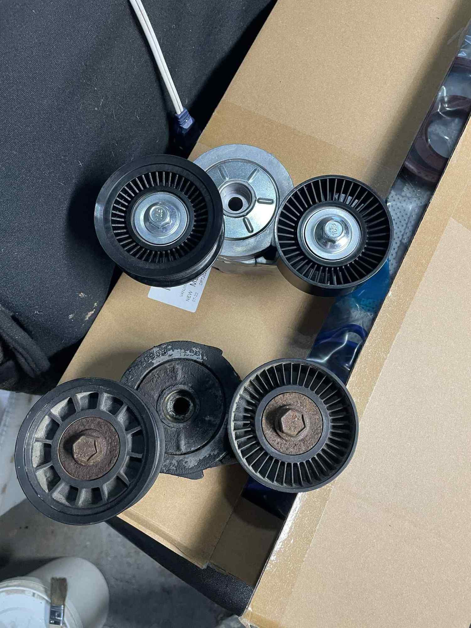

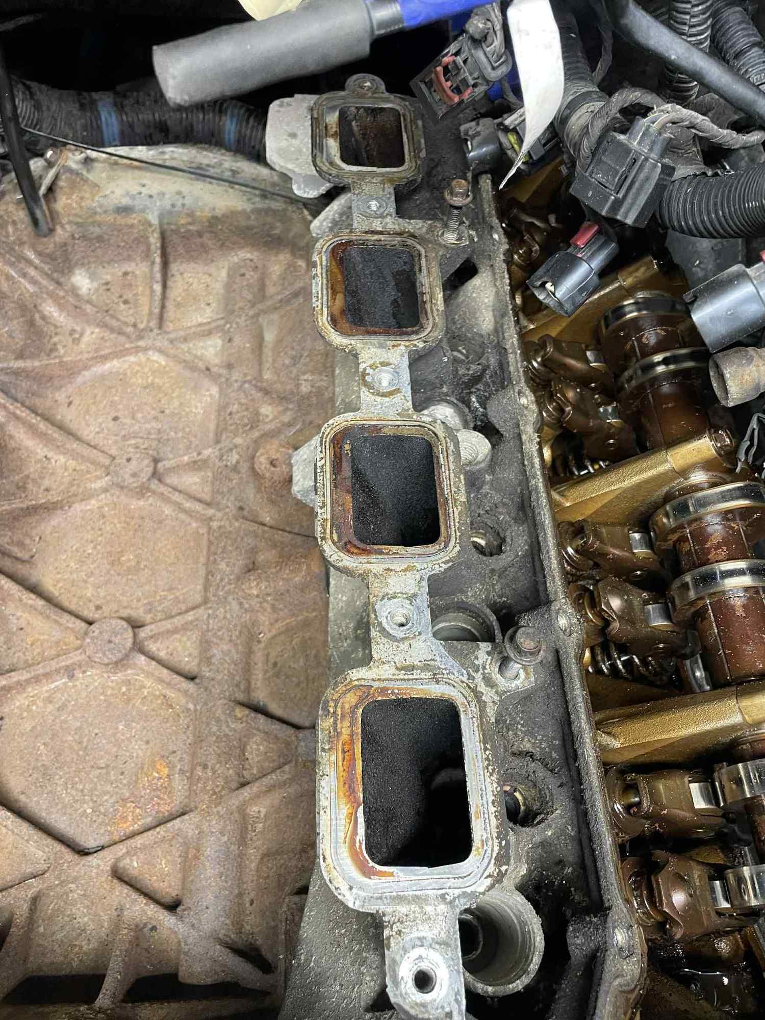

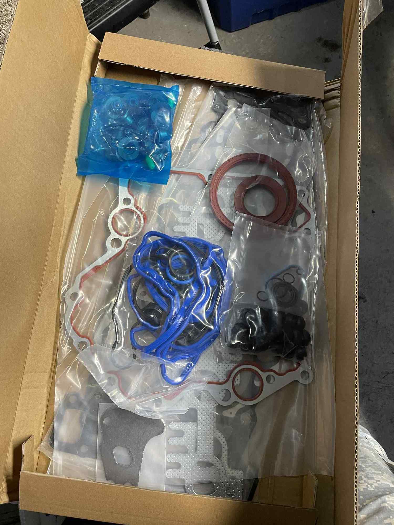

New Parts rollin in... cleaned up the intake surfaces and PB blasted the manifold bolts to soak a few days. Oil filter, thermostat belt tensioner, spark plugs and more....
