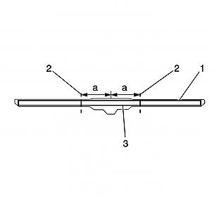

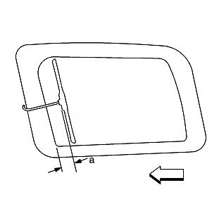

I found the instructions for installing this new remote and now I know why it takes 2 hours. You have to install a NEW antenna to the inside of the quarter glass on 2008's and at the top of the quarter glass trim panel on 2007s.
Here is the 2007 location on the trim panel:
Name:  2007 antenna.jpg
Here is the 2008 location on the quarter glass:
Name:  2008 antenna.jpg
This is a terrible picture of the antenna, but it's all I have right now.
