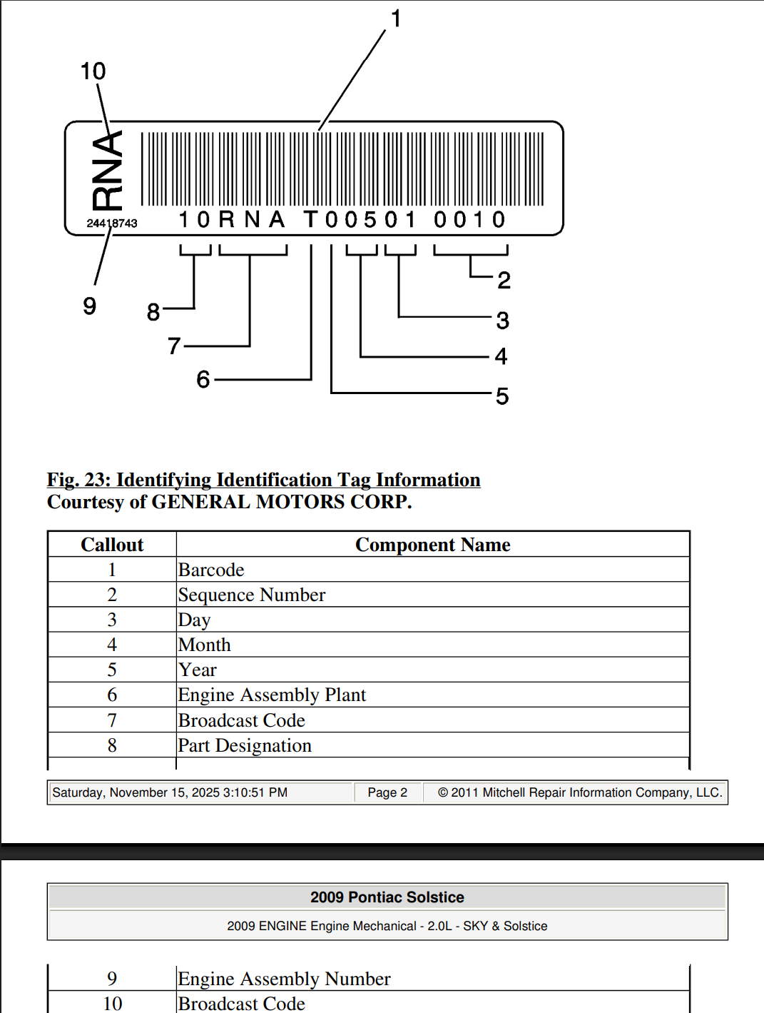

In case the above link dies in the future, I am attaching pictures for reading the broadcast code stamping on the oil-filter housing

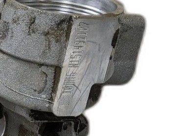

Found an alleged LAF on ebay with a broadcast code that makes no sense.
According to this, It was made in 2011, the 51st month(???), the 49th day(???)
Any suggestions?
