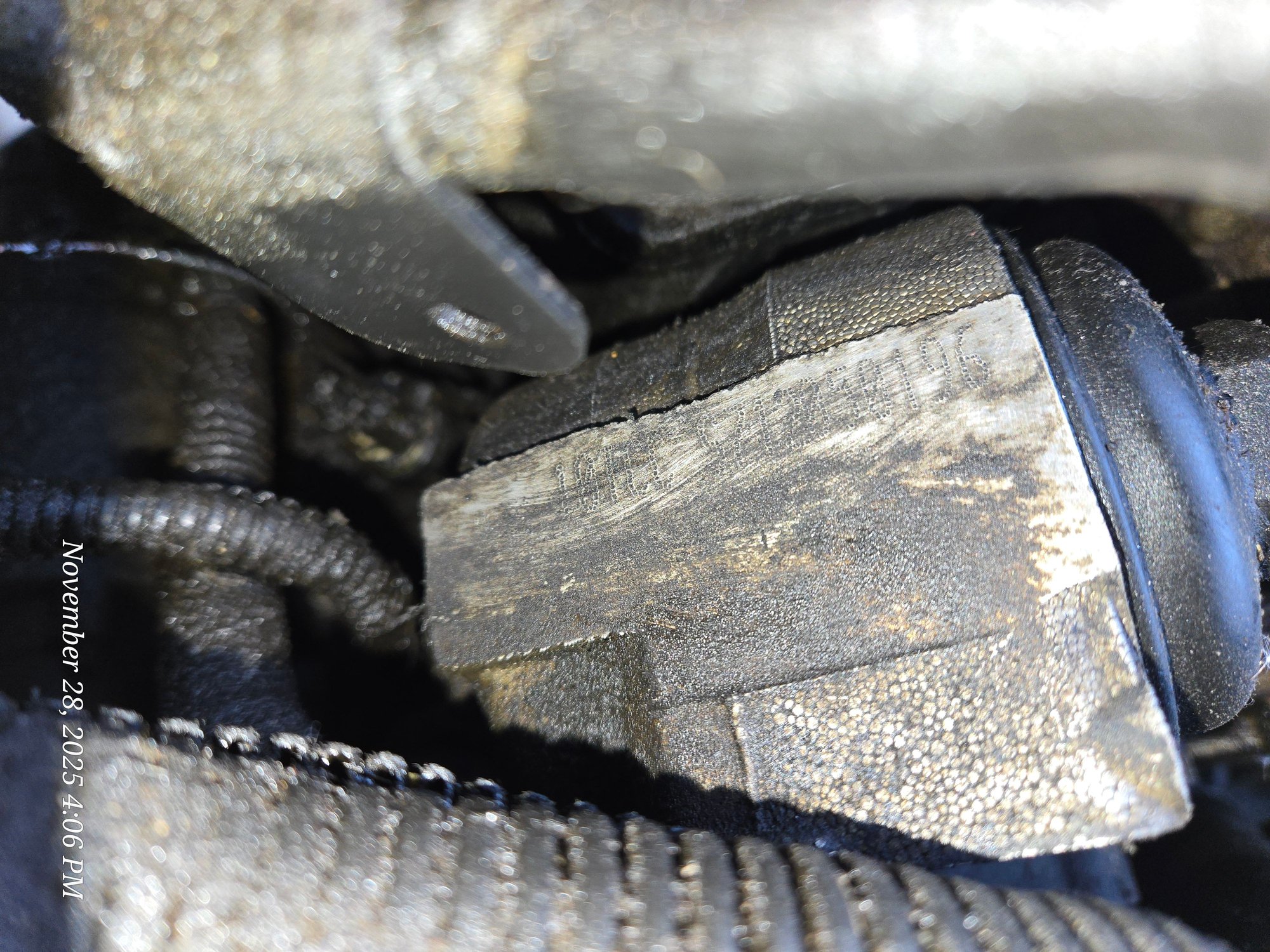

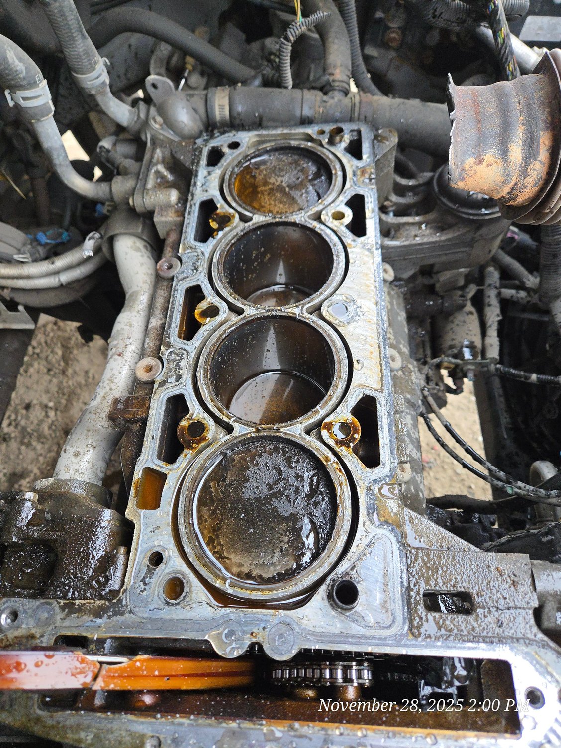

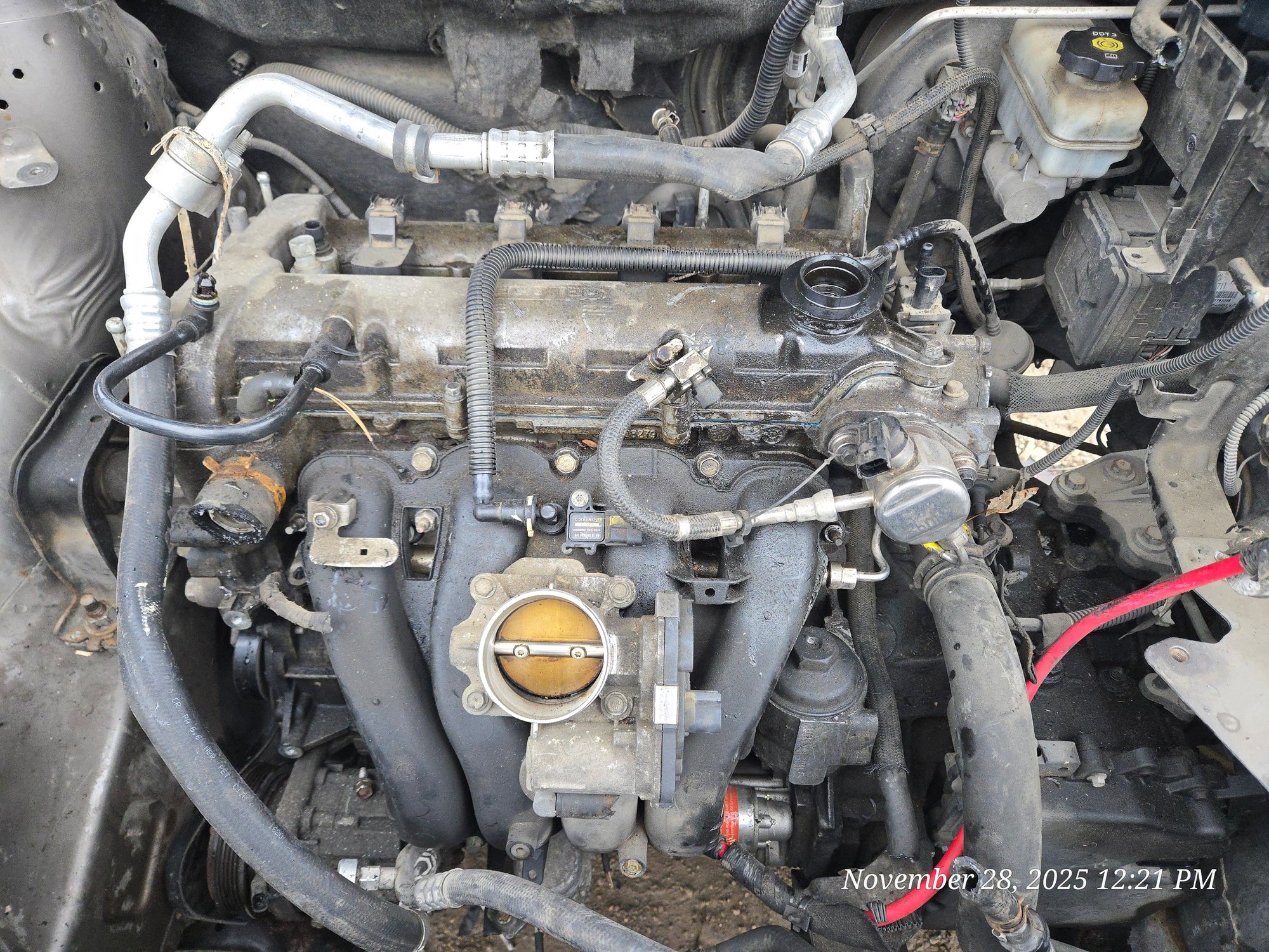

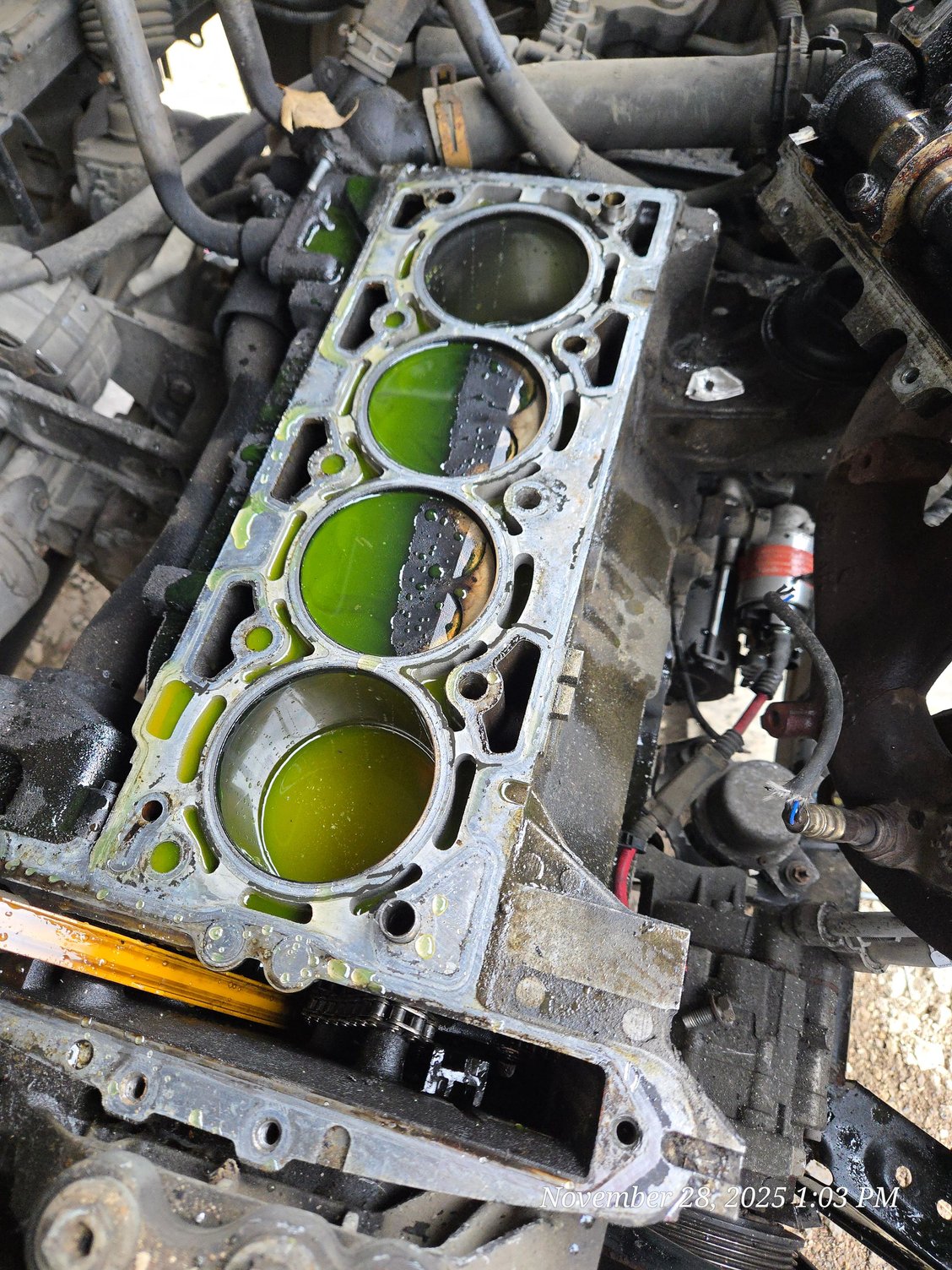

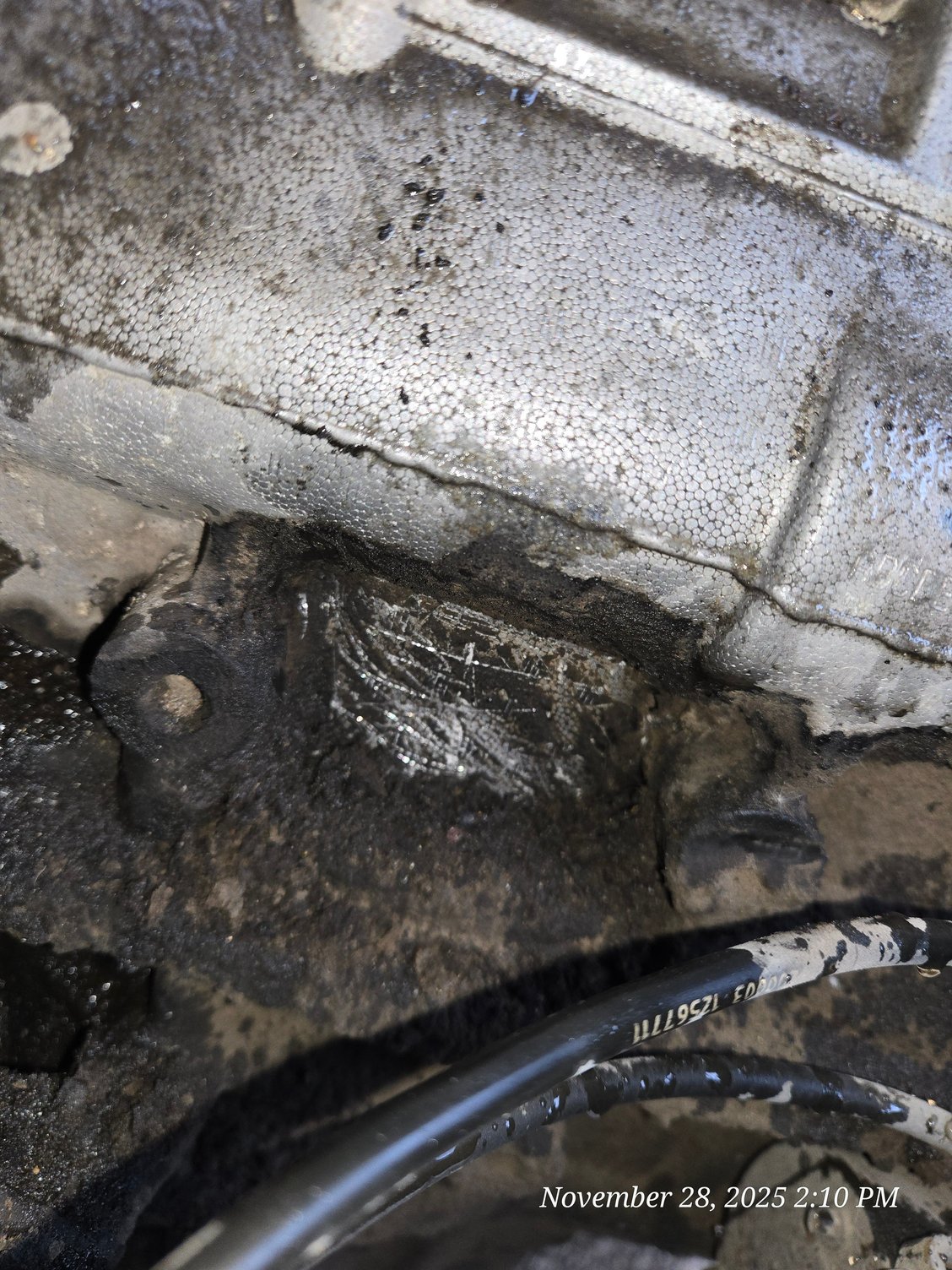

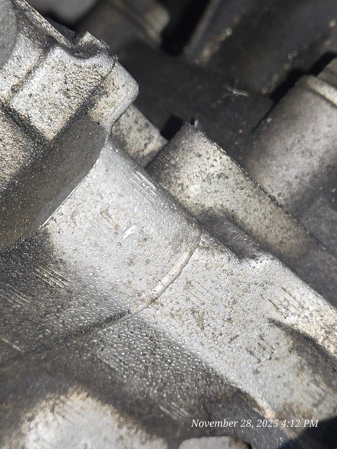

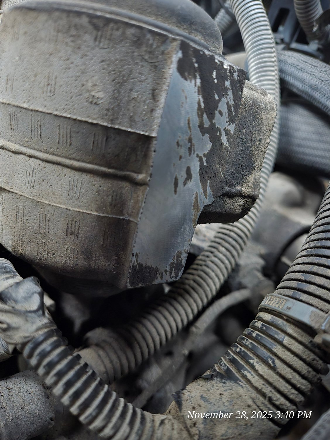

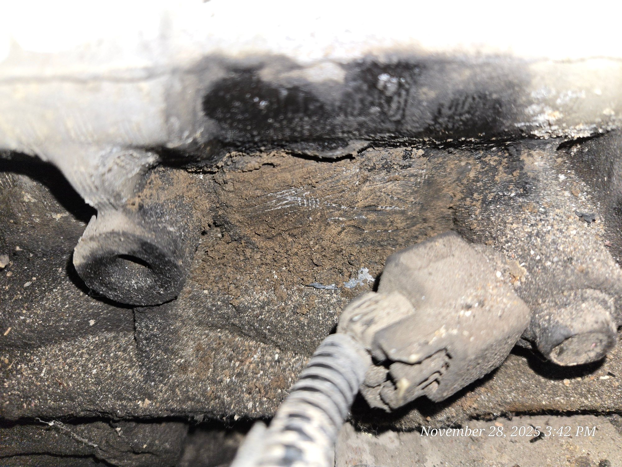

Before i begin this post i just want to define: When I say the foam-cast pattern is visible, I mean there is a pattern on the block visible that makes it look like Styrofoam. This is an indication it was made with a foam-cast method, which is weaker than sand-cast. Sand-cast was done on the earlier and later engines.

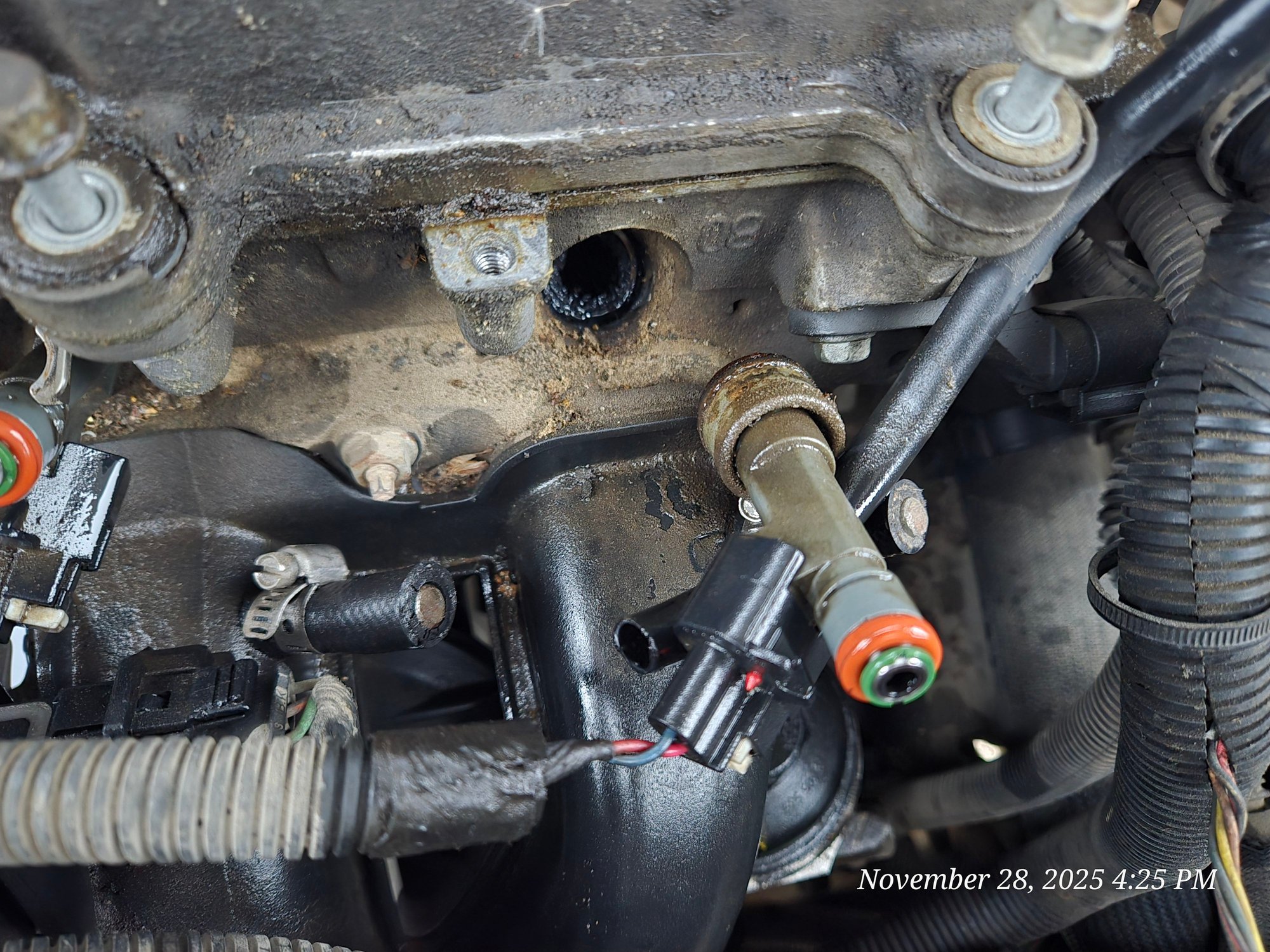

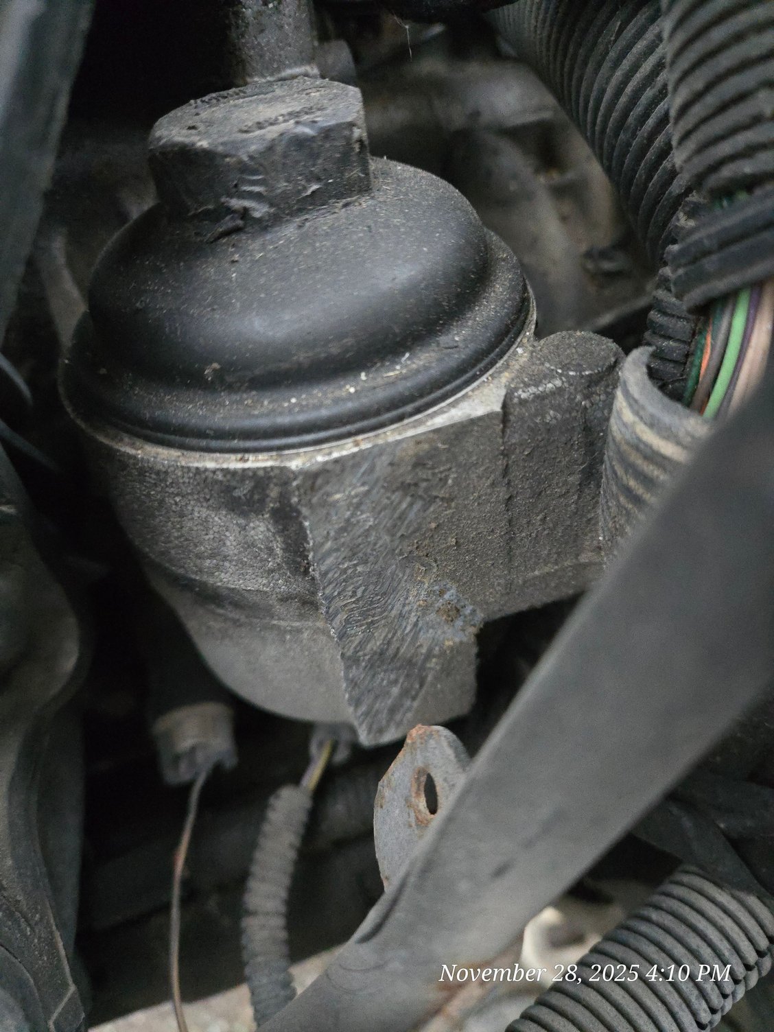

First, let’s look at the LE8 I found

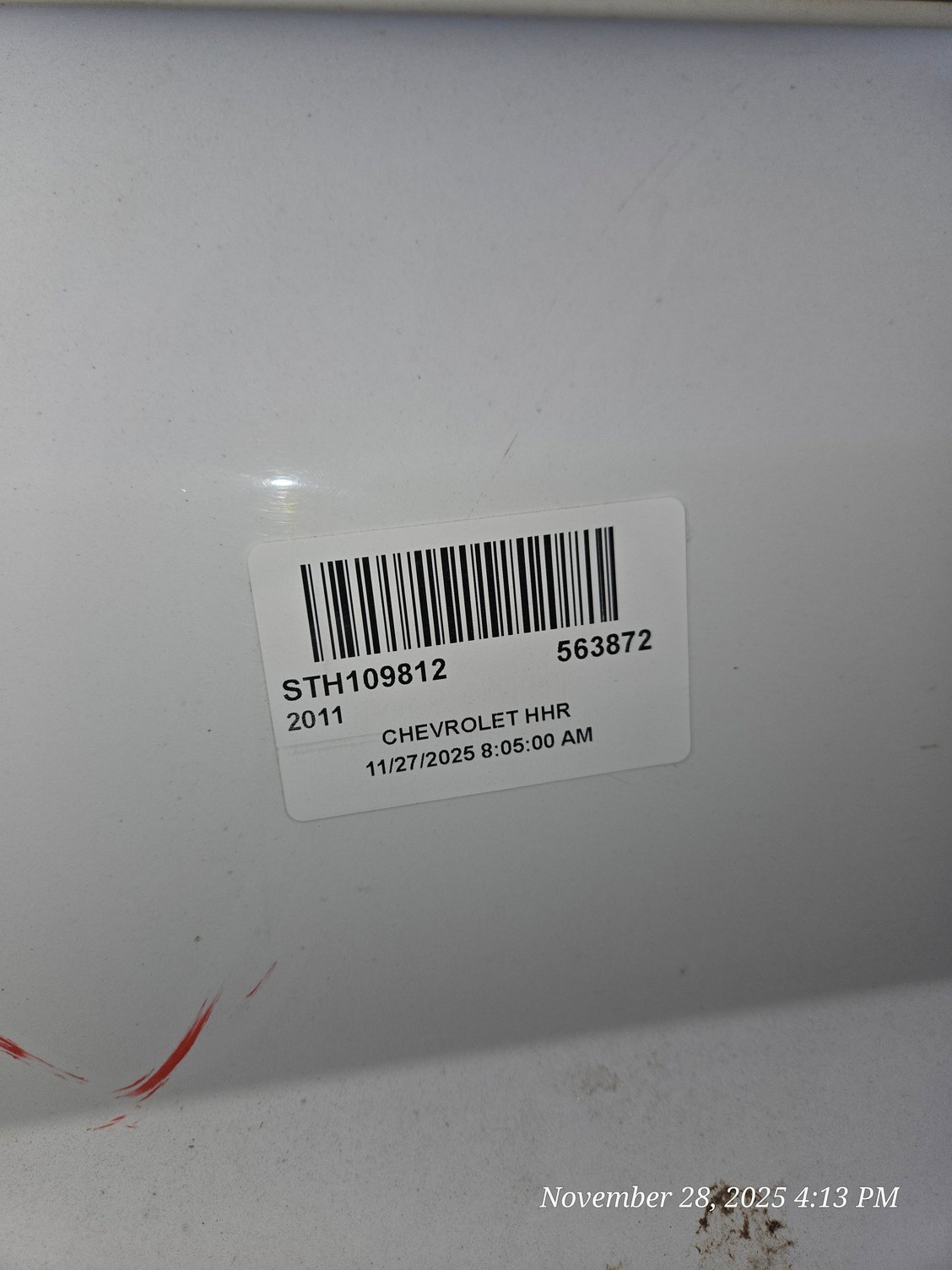

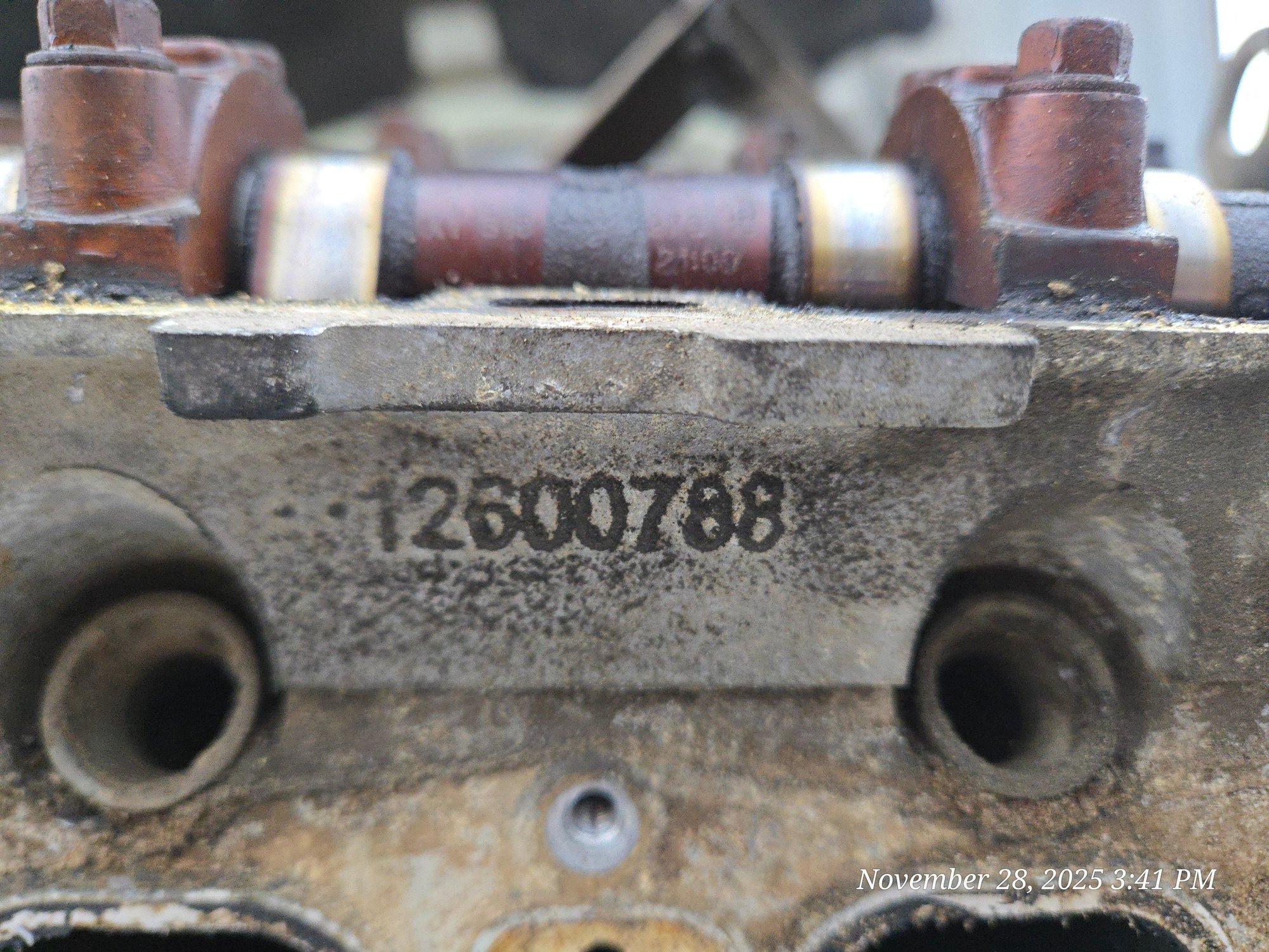

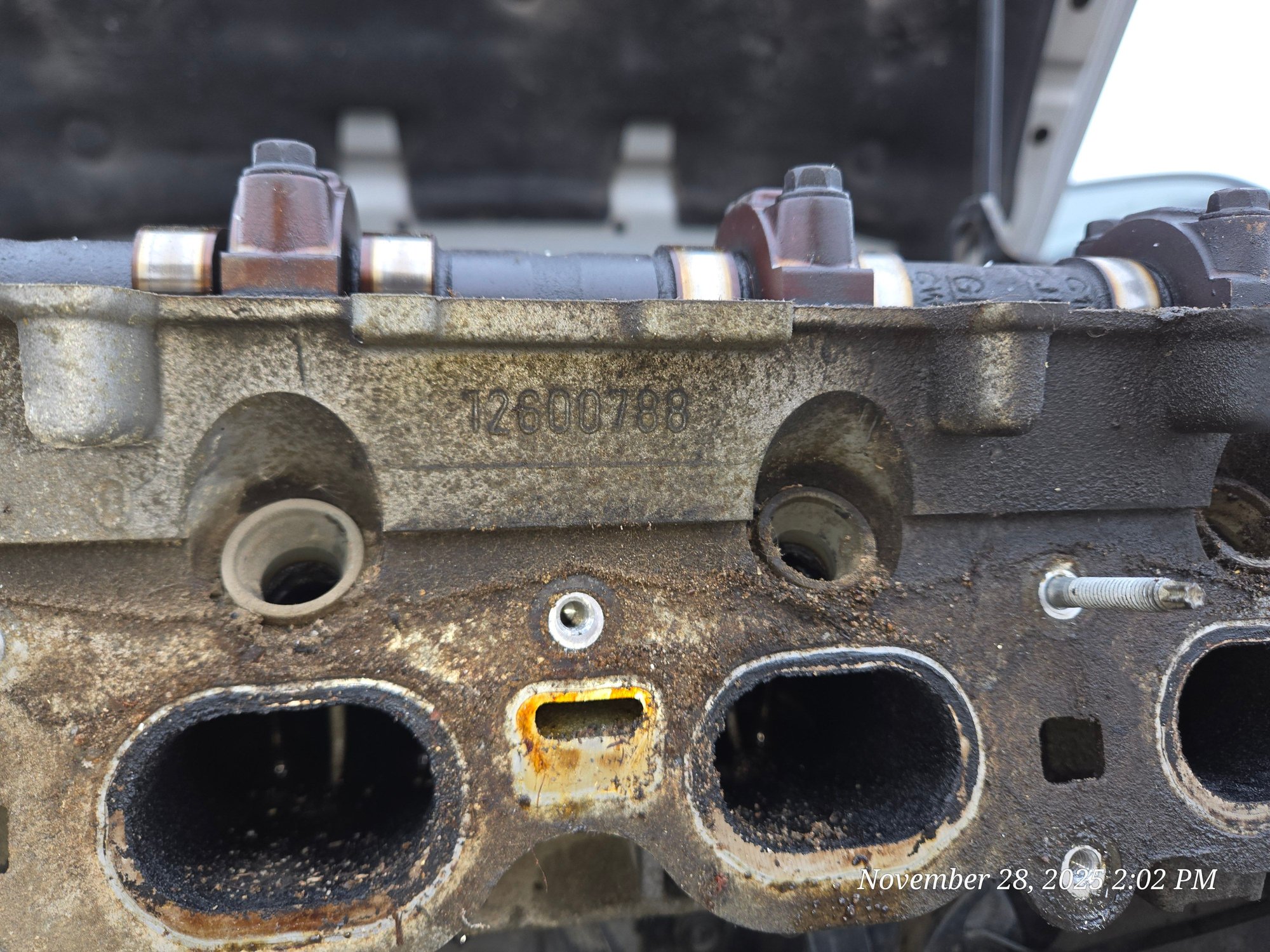

This batch of pictures show: 2011 Chevy HHR, 2.2L engine(2009+ 2.2L was LE8). Forgot to take a pic of the VIN. Blank oil-filter housing, foam cast pattern visible. Pistons are domed, AND have valve reliefs. Block is still open-deck(not reinforced design). All these things come together to make it physically identical to the LAP. Head part number is 12600788, could not find part number of block(stamping is not in same place as LEA)

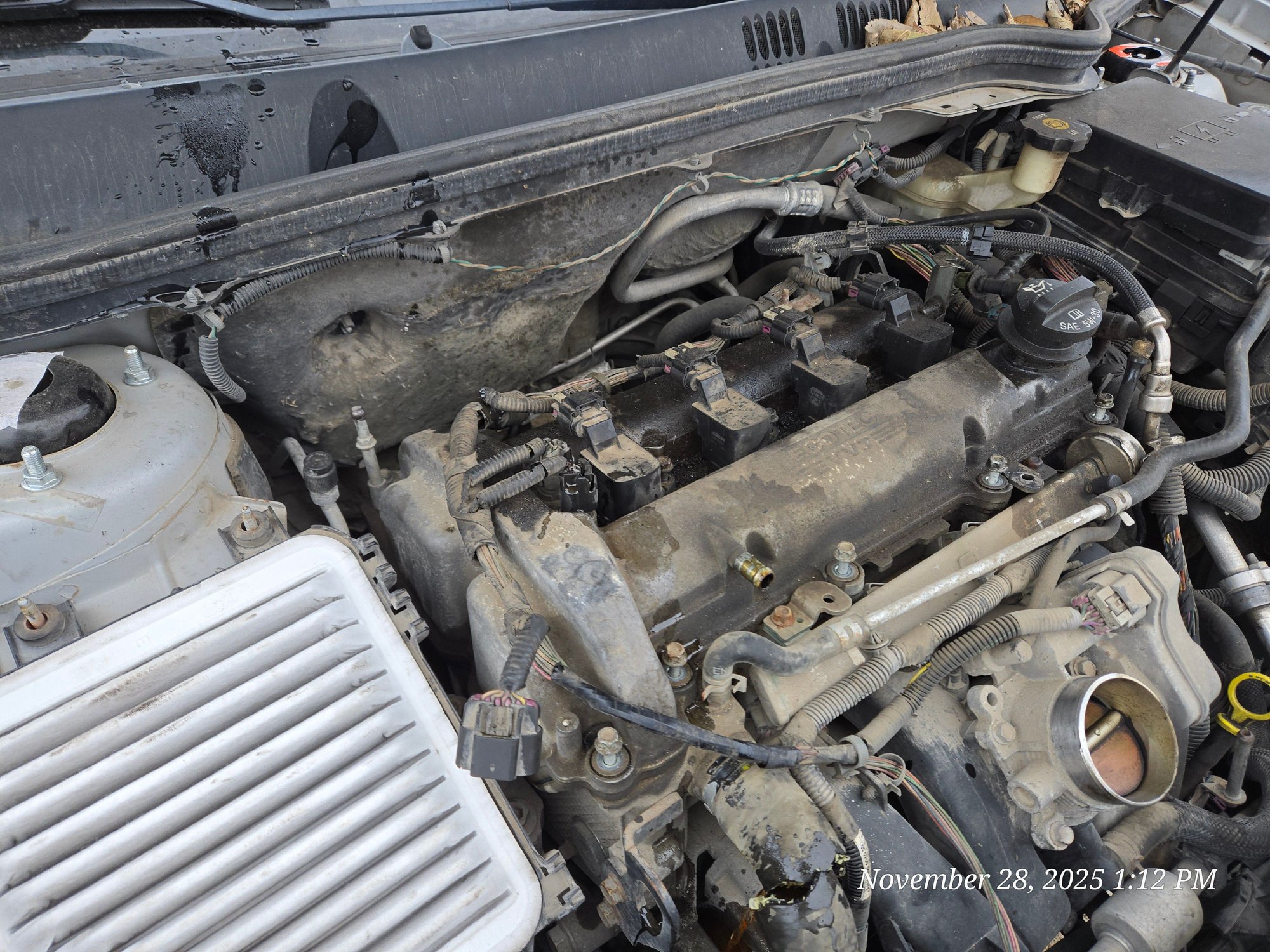

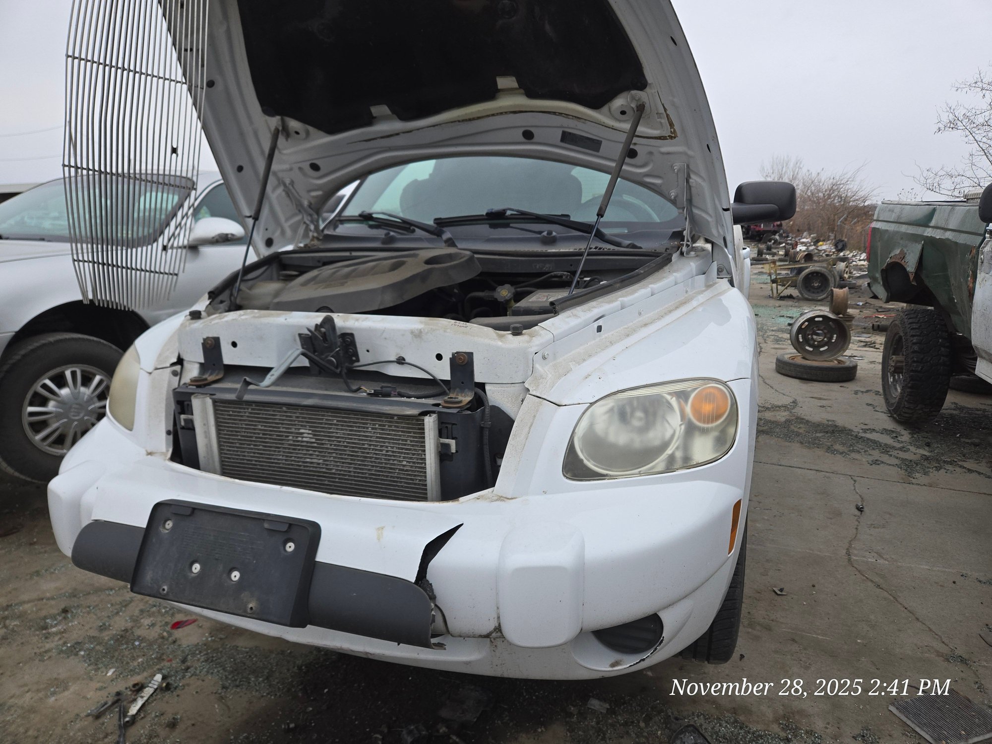

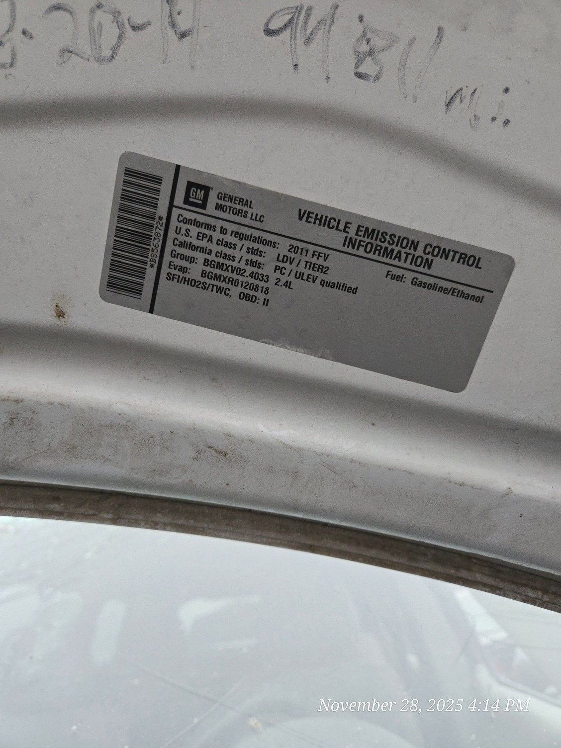

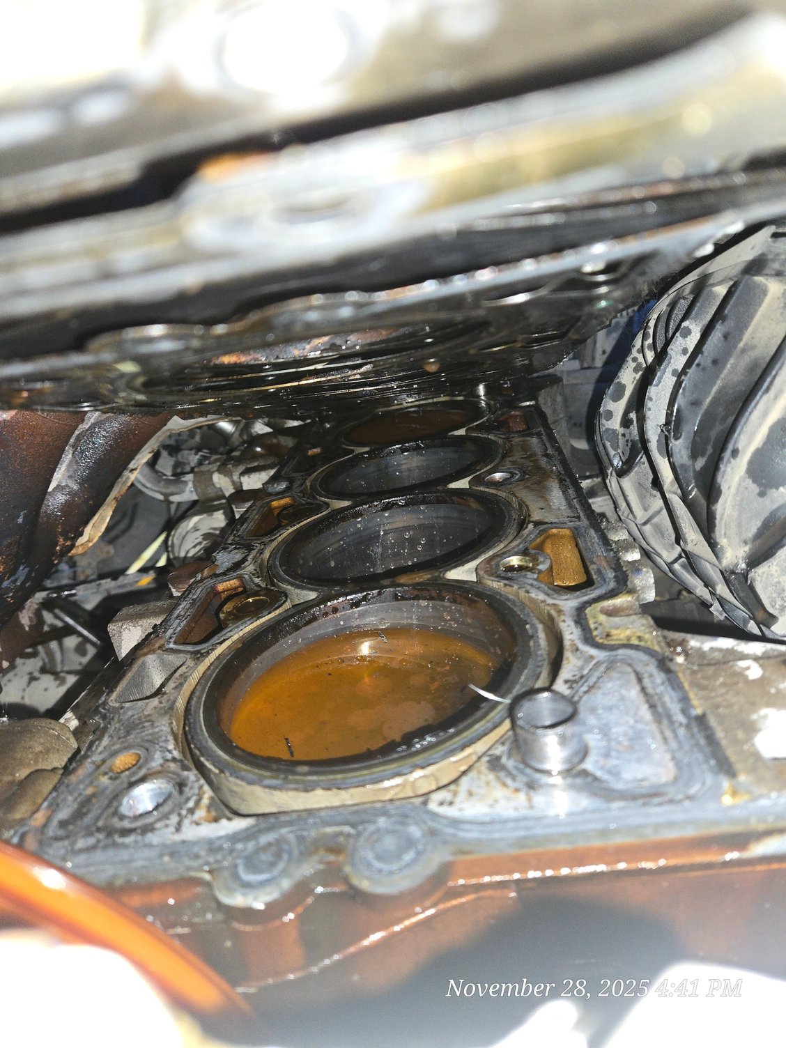

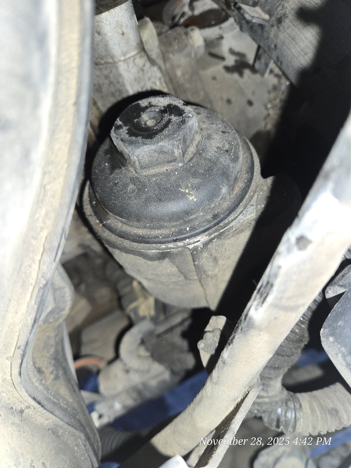

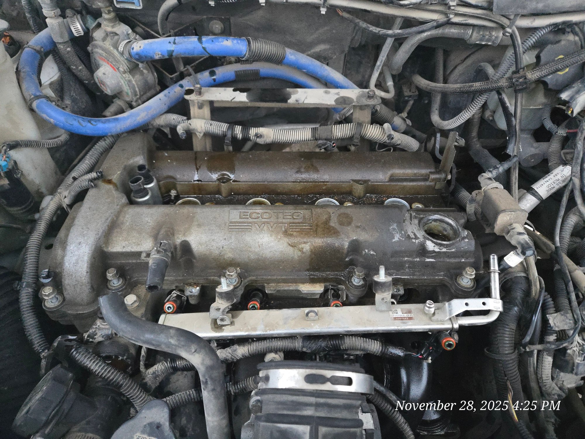

Next, here’s the LE9 I found.
These pictures show: 2011 Chevy HHR, 2.4L engine(2009+ 2.2L was LE9). Also forgot to take a pic of the VIN. Blank or dirty oil-filter housing, foam cast pattern visible. Didn’t have time to get the head ALL the way off so I couldn't see the pistons, but nothing has led me to believe they would be any different than LE5 pistons. Block is still open-deck(not reinforced design). All these things come together to make it physically identical to the LE5.

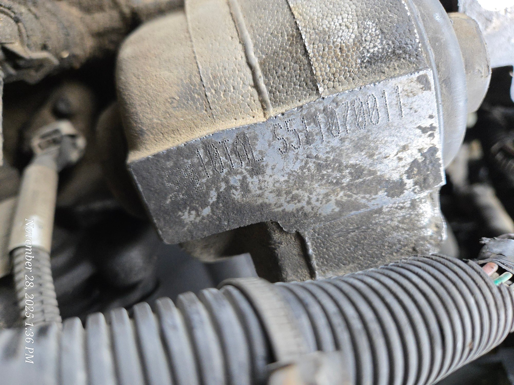

Then, the LE5.
These pictures show: 2006 Chevy Cobalt, 2.4L engine. Forgot to take a pic of the VIN. Oil-filter housing is stamped, “10TAL S511070011”. 7th digit(2nd digit in second group of characters) is 5, indicating 2005 build year. Foam cast pattern visible. Pistons have valve reliefs. Block is open-deck(not reinforced design). All as-expected. Head part number 12600788 stamped in.

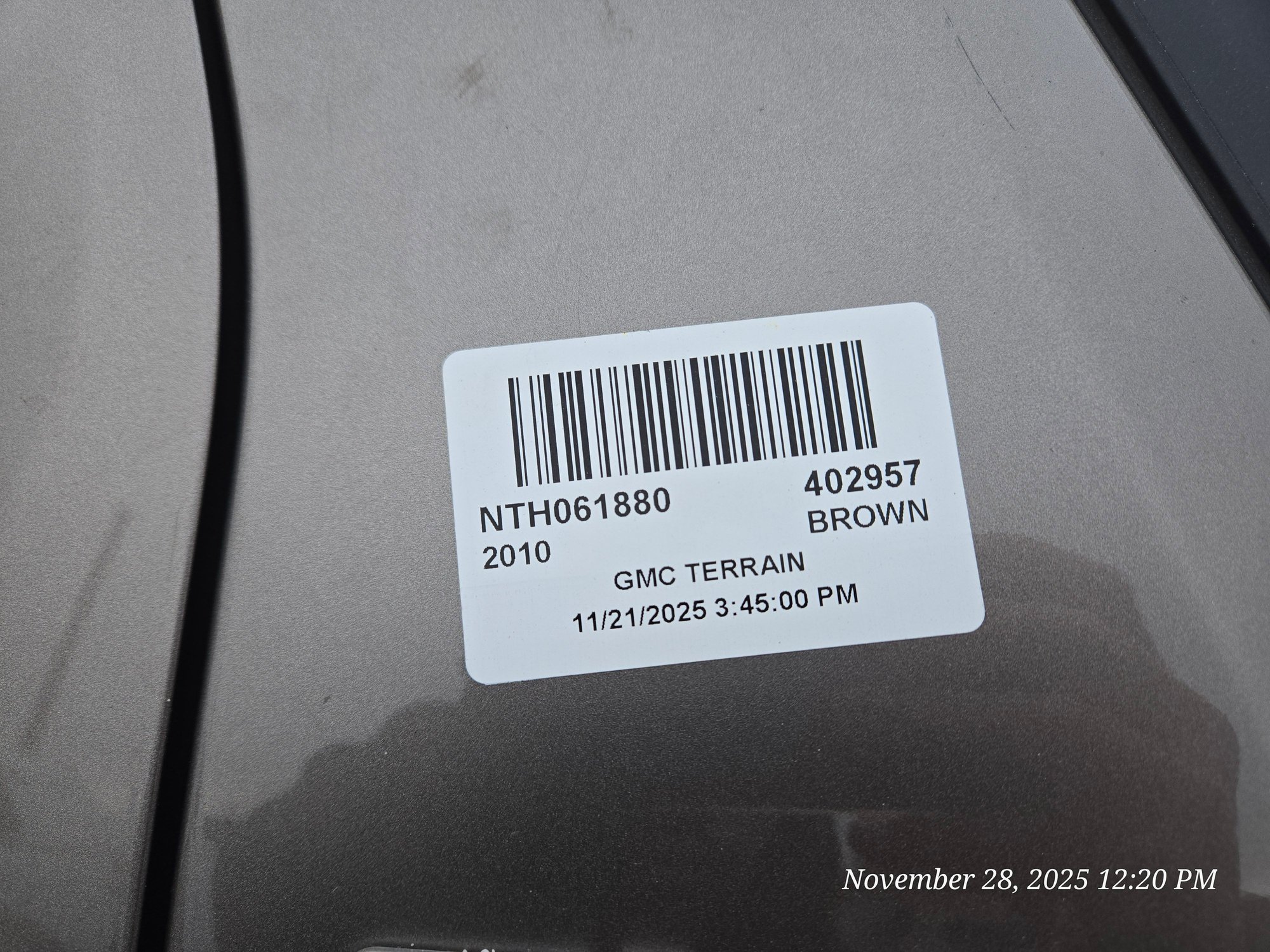

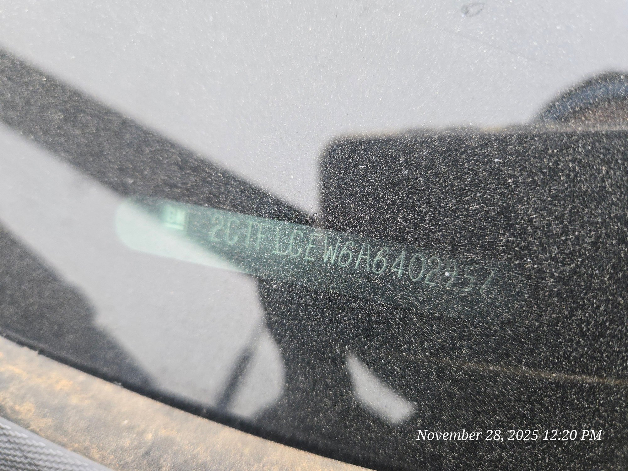

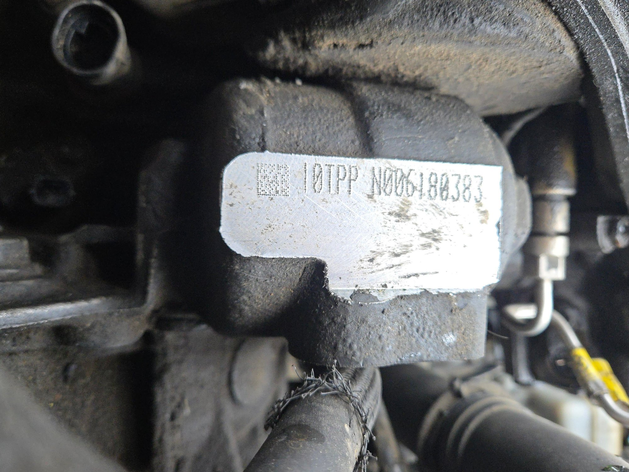

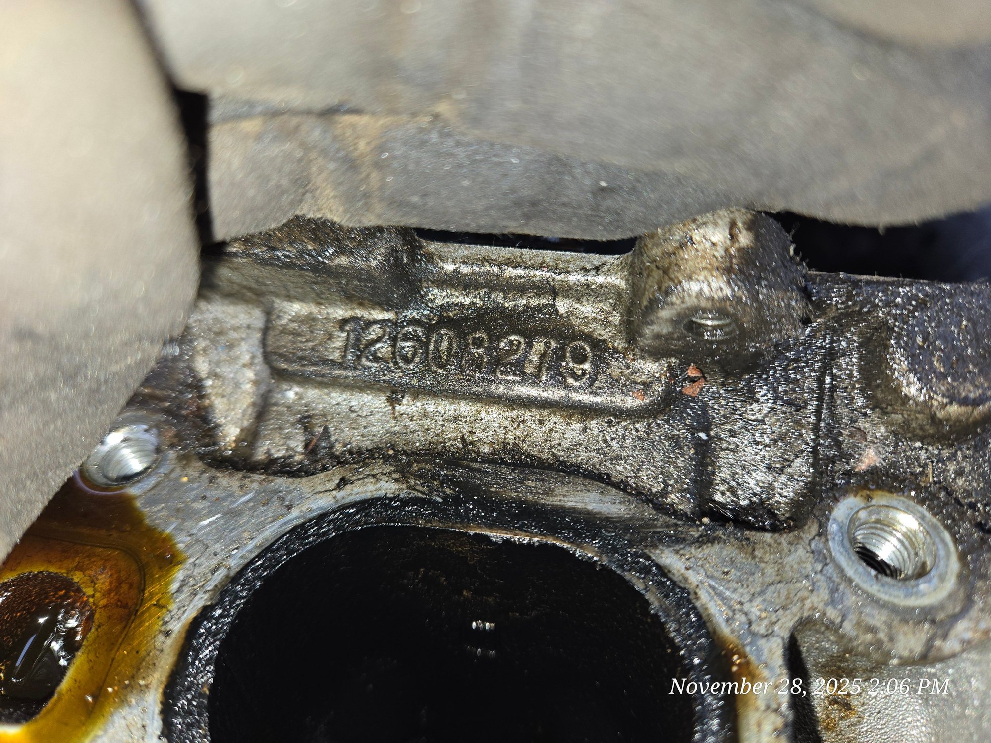

Also, the LAF.
This batch of pictures show: 2010 GMC Terrain, 2.4L engine. VIN 2CTFLCEW616402957. Oil-filter housing is stamped, “10TPP N006180383”. 7th digit(2nd digit in second group of characters) is 0, indicating 2010 build year. No foam cast pattern visible, indicating sand-cast. Pistons have valve reliefs. Block is reinforced, closed-deck design. I see no shared sections between the VIN and oil-filter housing code. Head part number 12592995. Block part number 12608279.

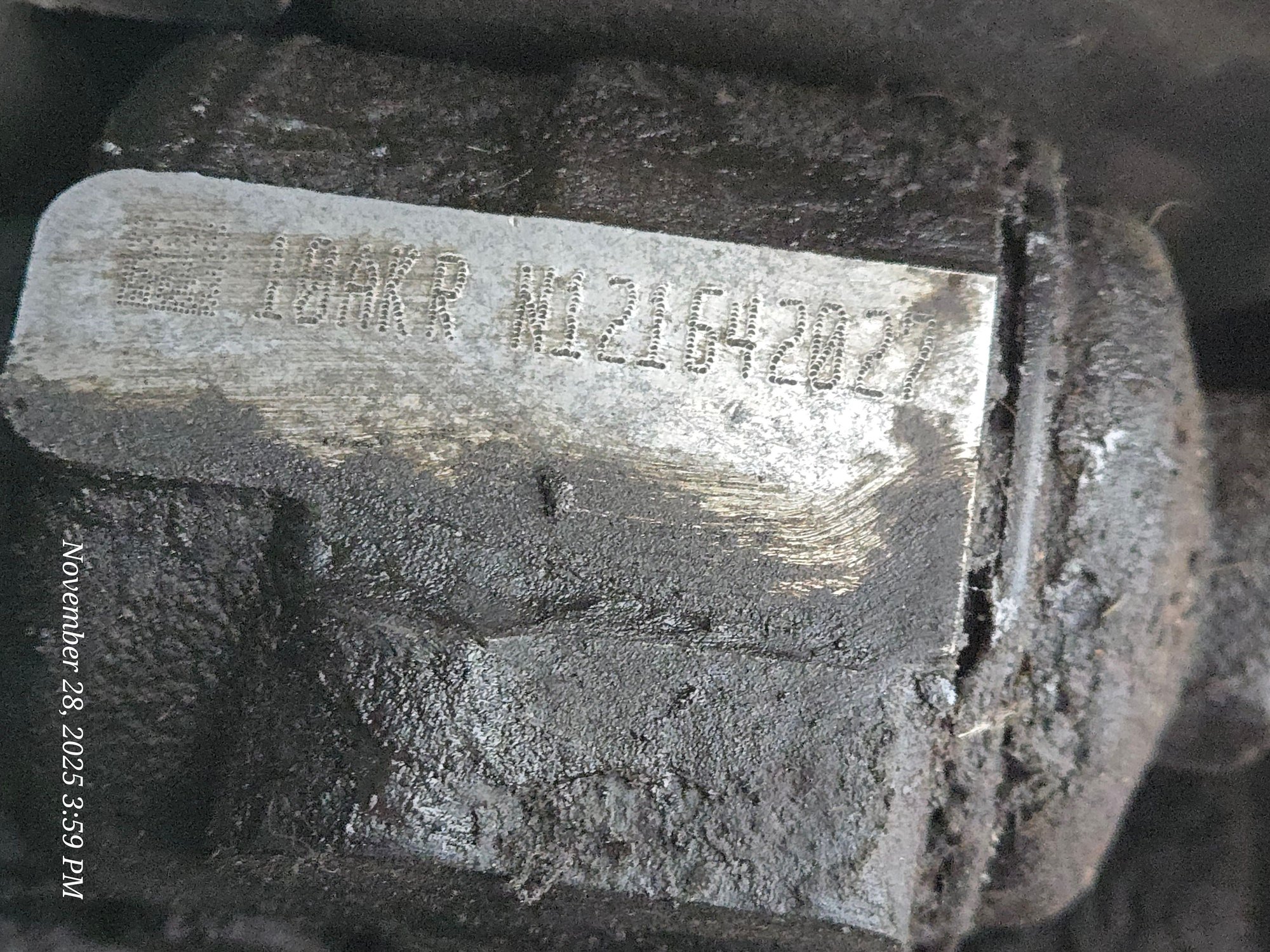

Last groups of pictures are a series that show oil-filter housings as well as make, model, and year.
Red 2012 Chevy Equinox(LEA), VIN: 3GNBABDB3AS651167. Oil-filter housing stamping: 10AKR N121642027. 7th digit(2nd digit in second group of characters) is 1, indicating 2011 build year.
Black 2008 Chevy Malibu(LE5), VIN 1G1ZH57B38F194951. Oil-filter housing stamping: 10TCC S712050196 7th digit(2nd digit in second group of characters) is 7, indicating 2007 build year. Foam Cast.
Black 2011 Chevy Malibu(LE5), No VIN pic. Blank oil-filter housing stamping. Foam Cast.
White 2011 Chevy Malibu(LE5), No VIN pic. Oil-filter housing stamping: 10TCC N005141568. 7th digit(2nd digit in second group of characters) is 0, indicating 2010 build year.
There are some conclusions that COULD be jumped to regarding oil-filter housing stampings, but all I have to go on right now are the stampings on 2.4L engines and the blank housing on the 2.2L. Will need more data to make any assessment on that front. Will be back around Christmas, will probably spend a little bit focusing on that.

Originally Posted by a_monkie
Also, the LAF.
This batch of pictures show: 2010 GMC Terrain, 2.4L engine. VIN 2CTFLCEW616402957....
2CTFLCEW6A6402957, not 1.
Looking up the VIN, it carries RPO "LAF." Sorry if I missed it, I just wanted to make sure you noticed that if you have the VIN, you have the engine RPO code, from (at least some) online VIN decoders.
But, as always, do not assume RPOs mean the exact same thing across years and models. Sometimes yes, sometimes no. For example RPO "L61" is VERY different in 2006 and 2007-2008 HHR.
To keep the confusion complete, sometimes there are "running changes" to part numbers or just specifications, within a model year, with no change to the RPO.
EDIT - another little tidbit; HHR SS (2008-201) carried engine RPO "LNF," but 2010 (only) had bigger injectors.
