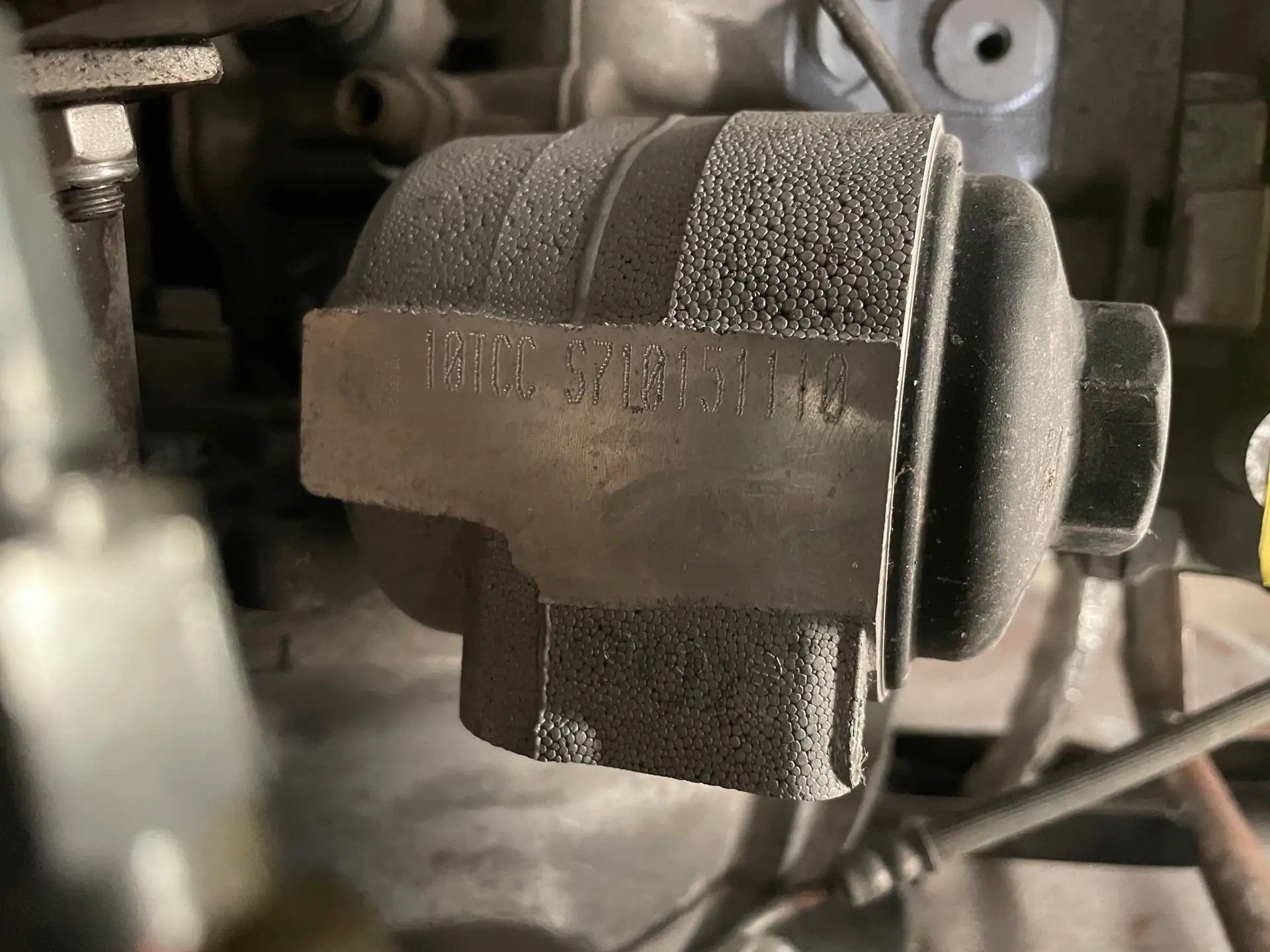

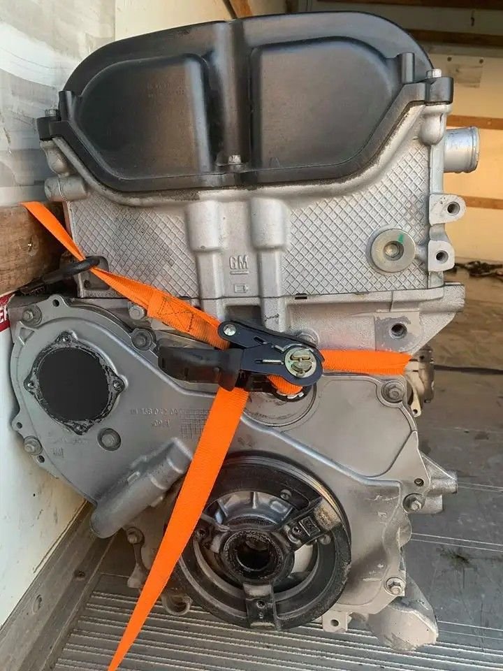

Ok, I'm gonna post a couple pictures I've found of some broadcast codes etched into the oil filter housing and we can decode them to the best of our ability.

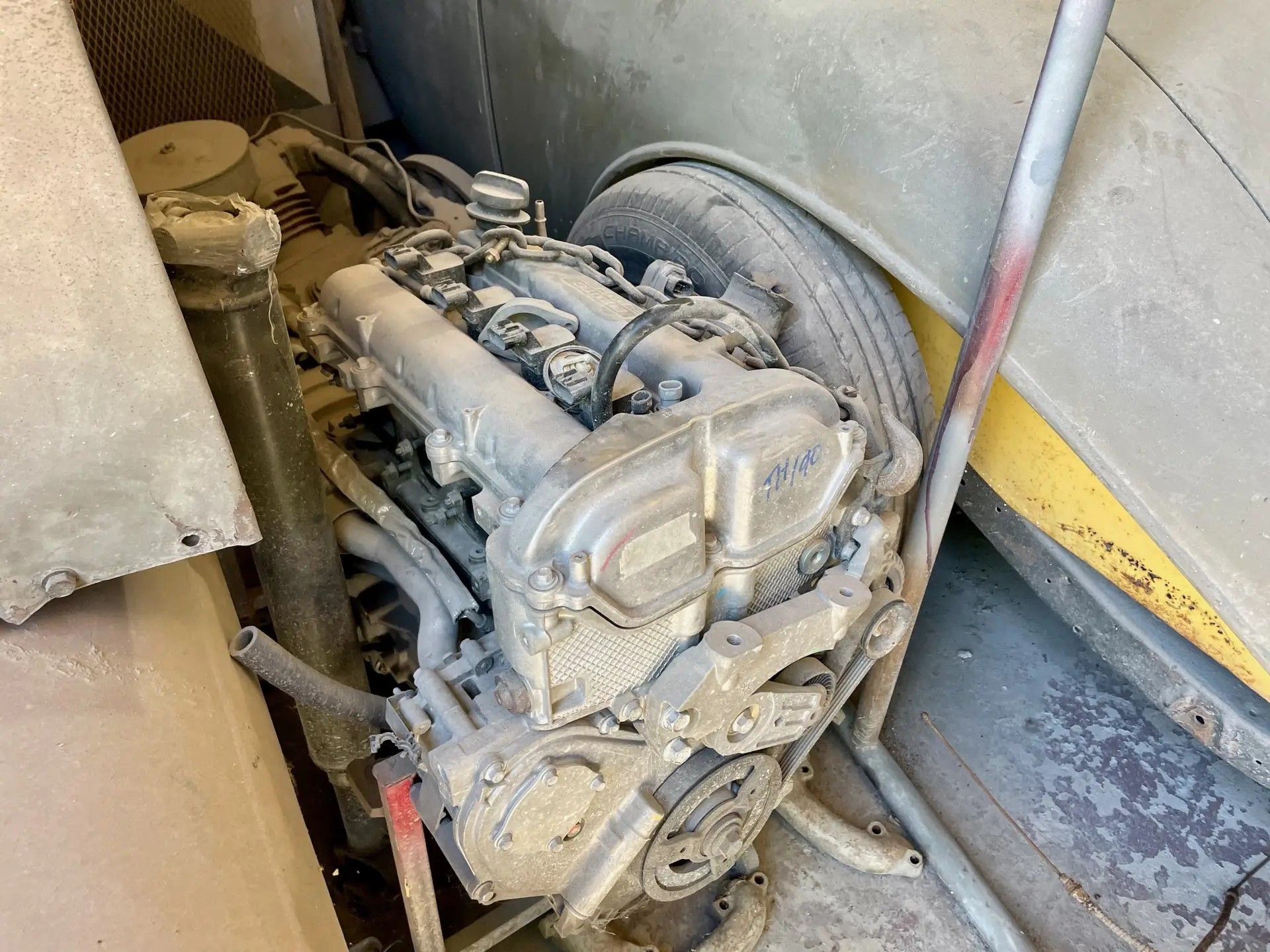

So here we have an N/A VVT engine with an engine code of 7(2007). This should be a 2007 or 2008(remember new model years come early) LE5 with the good rods, then. Nice and easy! Also of note for confirmation is the very obvious foam-casting pattern.
VVT Valve cover
VVT Valve cover

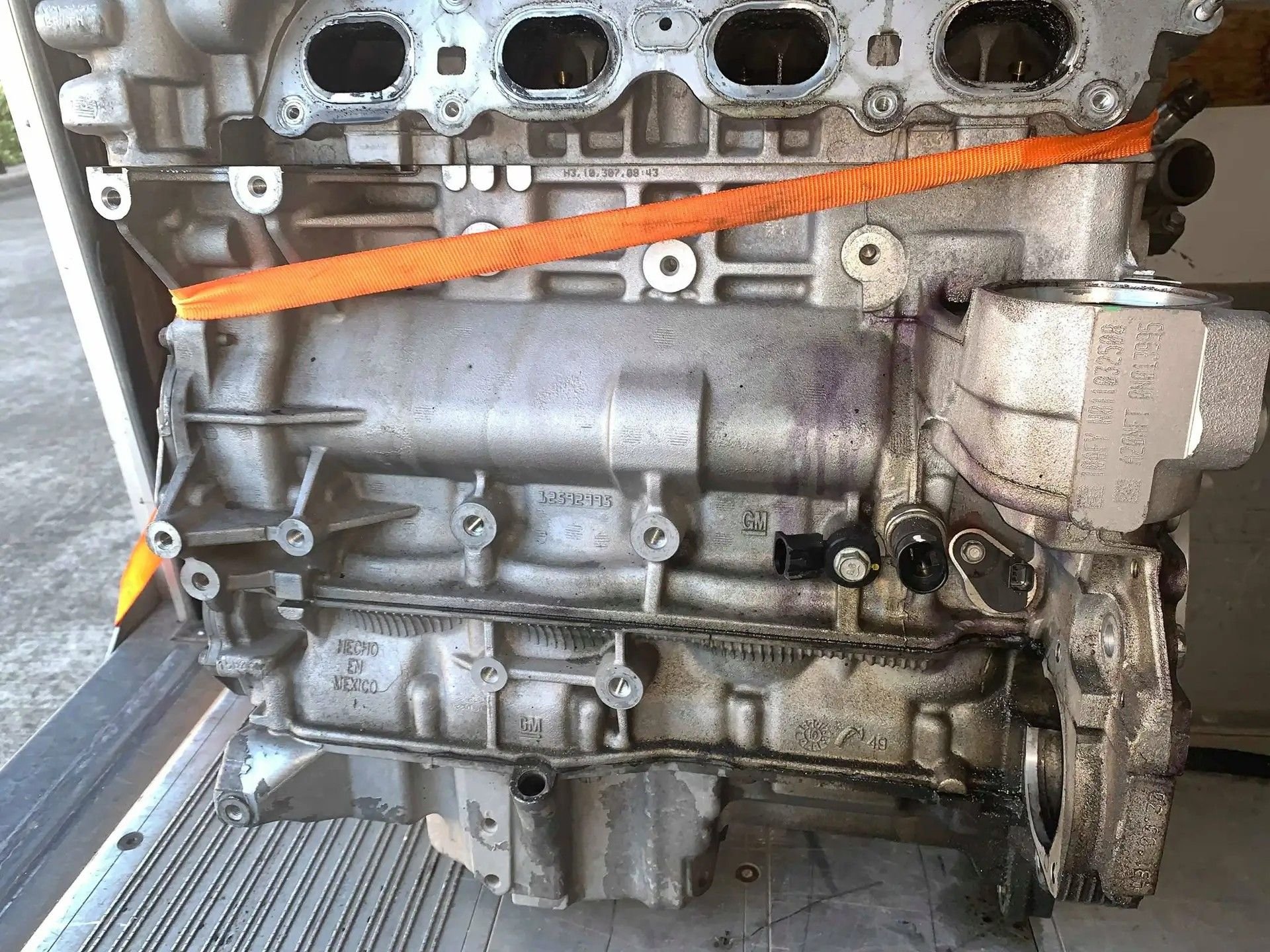

Block part number 12592995
Broadcast code on oil filter housing

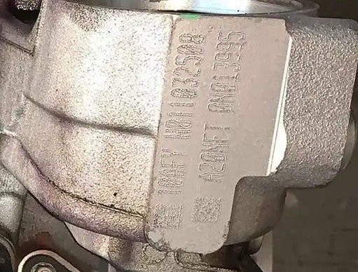

On this one, we have an obvious VVT valve cover, with "A20NFT" etched in the oil filter housing, which is the European name for the 2.0 Turbo LHU. That alone tells us the Engine, but then the year code 0(2010) tells us it had to be out of a 2011 Buick Regal or Saab 9-5, IF the engine was originally sourced from the US. I do not know what the rest of that code after the A20NFT means.
The casting pattern in most definitely NOT showing the foam pattern, so it's also a sand-cast block.

Old Nov 15, 2025 | 04:01 PM
Posts: 40,068
Your 1st photo shows a VVT engine, a 2.4 from 2006 to 2011 HHR would have this style valve cover as would the 2008 thru 2010 2.0 SS and the 2009 thru 2011 2.2 litre. Our trucklets did not get the black plastic valve covers like the Buick or Equinox of later years .we did have direct injection in the 2.0 SS only
Lost foam cast is not the same as sand cast, does not leave the same surface

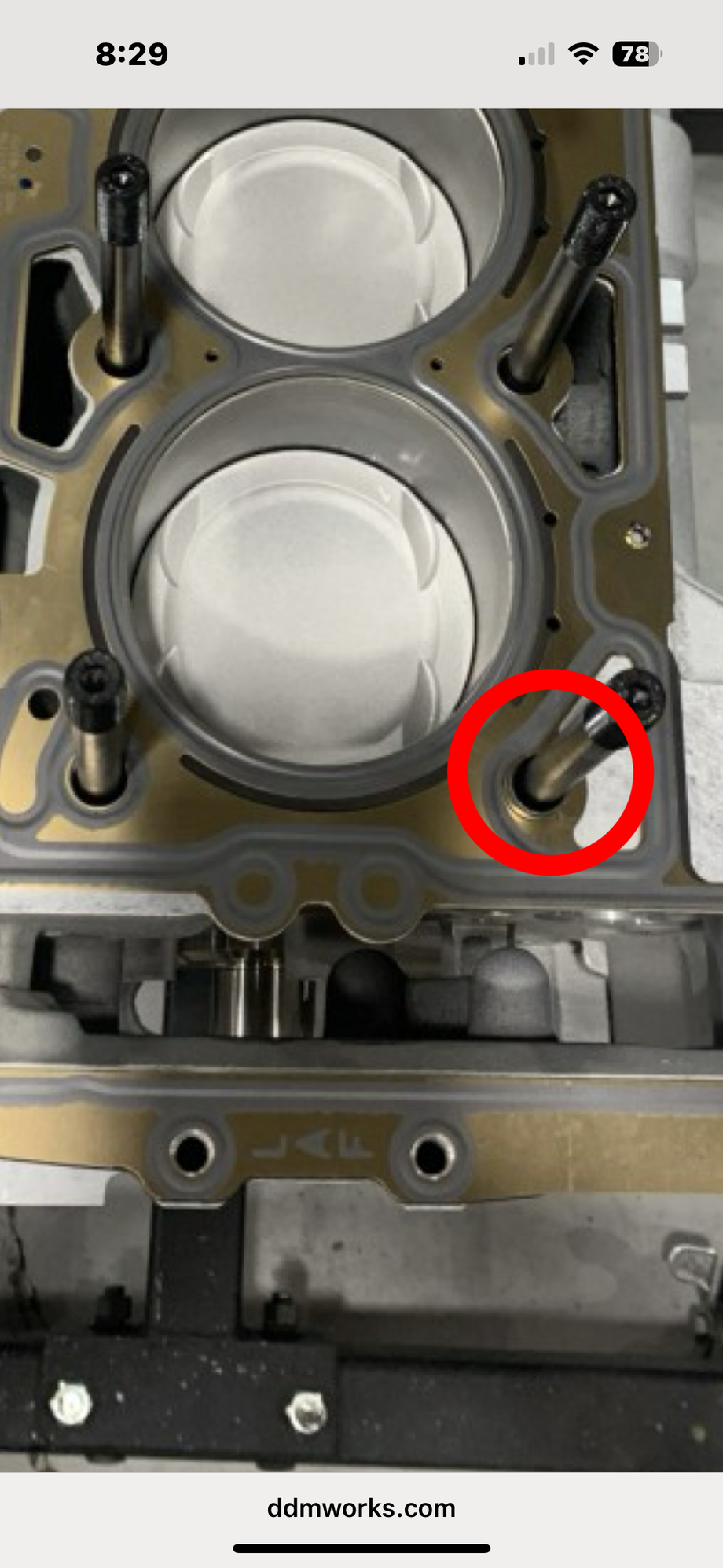

Posts: 40,068

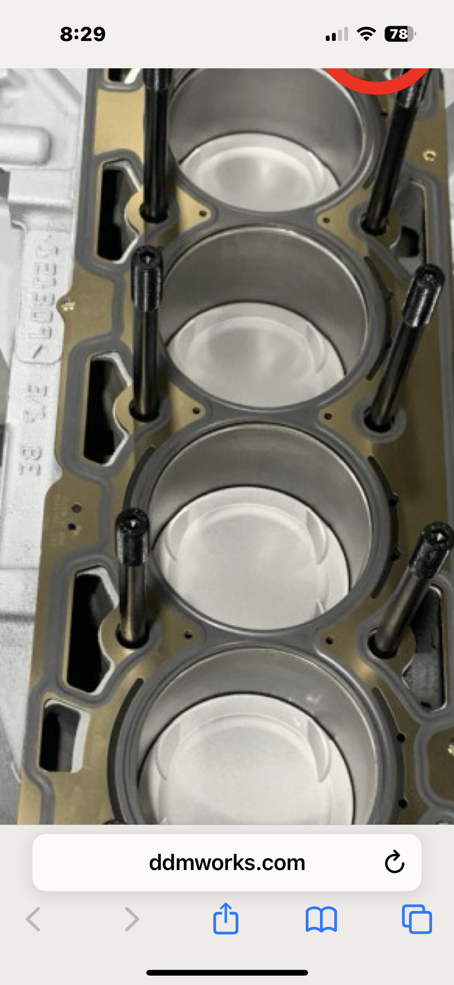

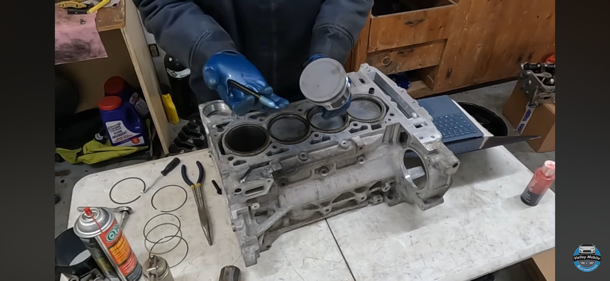

The 2.4 pistons have four valves reliefs
This is a 2.4 being assembled, note the valve relief.
A better view of 2.4
