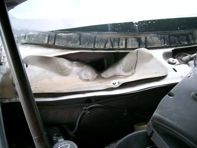

There was a butyl patch on your 2007?
My 07 had a cowl opening like this with no patch
The opening didn’t go to the bottom of the windshield like this
Yes...there was a butyl patch on my 2007. I thought I posted a pic of it when I replaced it. Or when it was still attached.
Old Aug 17, 2020 | 02:01 PM
  #66
Posts: 40,096
Just wanted to confirm, 2006 and real early 2007 had the patch

Posts: 11,721
FYI. For those of you that have the cowl cover off for whatever reason. Here's a little thing you can add to keep leaves and debris from entering the cabin filter area. A piece of window screen to cover the hole. I added this to mine.
The pic in the post above is my car.
This pic below is after I cut and installed a piece of screen.
