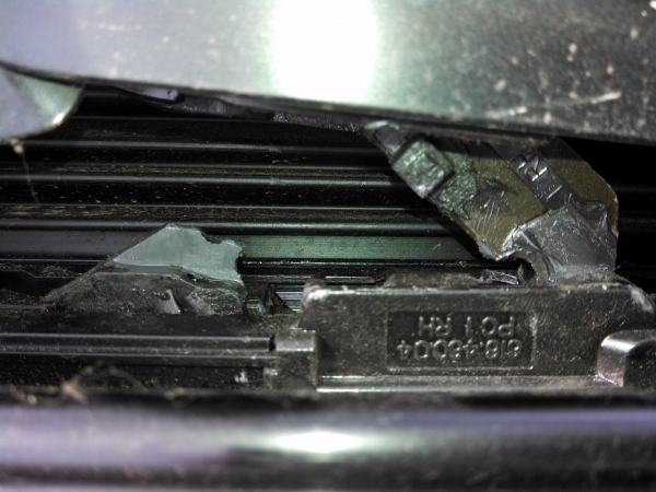

So, one side of my moonroof has movement up and down and will rattle when in the vented position. Seems there is a broken piece of plastic. Replaceable part?
This view is only available with the moonroof out of the car. You cannot see it from the roof opening.
Old Apr 11, 2013 | 10:28 PM
Well it has a part number that looks like 81848004, but its not coming up as valid on any GM parts sites, so you might call your dealership parts department. You'll probably end up having to buy that part of the mechanism as an assembly.
