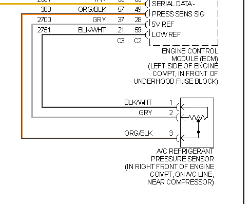

That’s not a switch, it’s a sensor, apparently a simple variable resistor from which the ECM is using two analog values to determine if it’s OK to run the compressor. Maybe there’s no jumper configuration that would result in an acceptable condition. Even if you knew what the proper ranges were it seems like it would be a lot of trouble to test the sensor, and a bit of trouble to R&R it. I would think both too low and too high pressure would make starting the compressor a no? A bad sensor would explain things. I’ve never checked if my scanner will tell me refrigerant pressure. Someone who know something about auto a/c will know what a normal pressure range is, and that’s not me.

The "on" signal for the compressor comes on a wire directly from the BCM. Inputs used by the BCM are the button on the dash, the fresh air control, the mode control the pressure switch. I guess that narrows it down to the computer. (sarcasm).
Ebay has used control panels starting at $22.50. One of the members parting out cars could probably beat that. GM pressure switches on Amazon go for around $20. $45 and 15 minutes would replace everything but the compressor pressure circuit.
