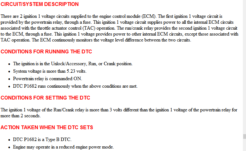

P1682 means that ignition circuit #2 is shorting to ground at the power train relay. Or open at either the run/crank relay and/or the powertrain relay. This is the cause of the "reduced power mode".
Since the engine does run I would focus on the run/crank relay #51 fuse #43 under hood. The powertrain relay would shut the engine down.
