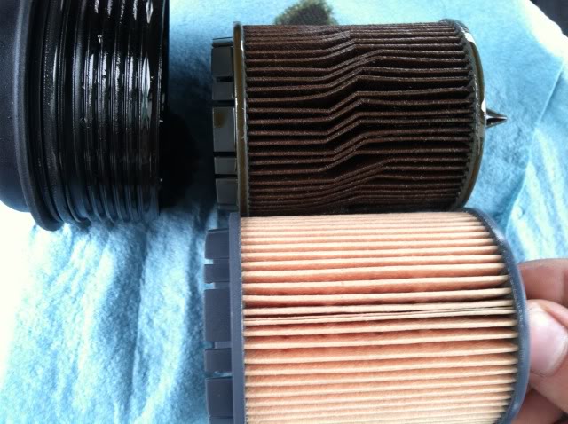

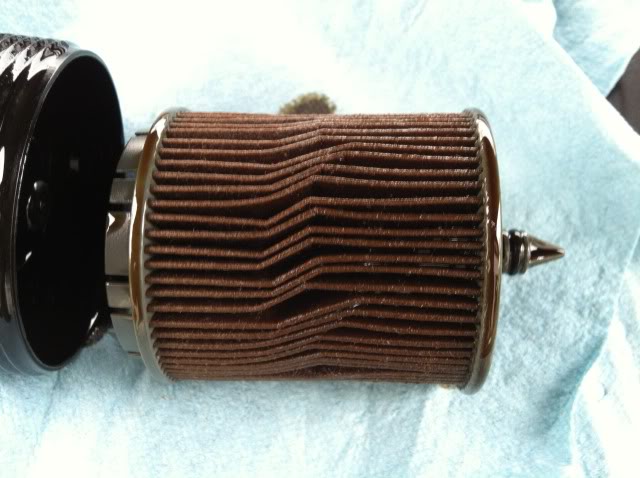

I was talking to a friend who has a 2011 Malibu with the 2.4L. He just changed his oil after 7,000 miles and his filter was collapsed also.

3000 mile update:
The Wix filter has begun to collapse also. I replaced it with a Partsmaster filter being that both filters seem to perform the same (poorly).

I don't think they are collapsed - I believe they are twisted during removal, or installation if the o-ring hangs up. Try lubing the o-ring before installation and see what happens.
Re: Fram - imo they are overrated, and having encountered problems with air cleaners that came apart, and finding Fram would not stand behind them, I will only use their products if I am desperate and there is nothing else available.

I agree that they do not look collapsed. Looking at the way they are tweeked would indicate that the material is soft from oil soaking so it gives. With one end stuck in the cap and the other jammed in the block, seems like a fair assessment to me.

Just a suggestion to the OP. Next time you preform an oil change, why don't you install the filter and then before you start the engine and soak it with oil, you pull it back out and see if it has colapsed. At least it would let you know if it is crushing on installation.
