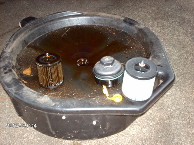

Since this topic was resurrected AGAIN, I thought I would review the posts from the beginning.
While a believer in the installer error theory, I believe I found something worth mentioning.
Review the OP's pictures again. While the statement, "they appear to be the same" may have some validity, that may not be the case. Look very hard at the pictures of the 2 filters. Do you see the difference? The "pointed" end is slightly different. The point on one appears to be rounded and slightly larger and the other appear to be slightly smaller and thinner. The gasket also appears to be slightly wider than the other. Could the difference cause the problem, at least in the OP's situation?
But what donbrew says still is the definitive. Does it make a difference.
