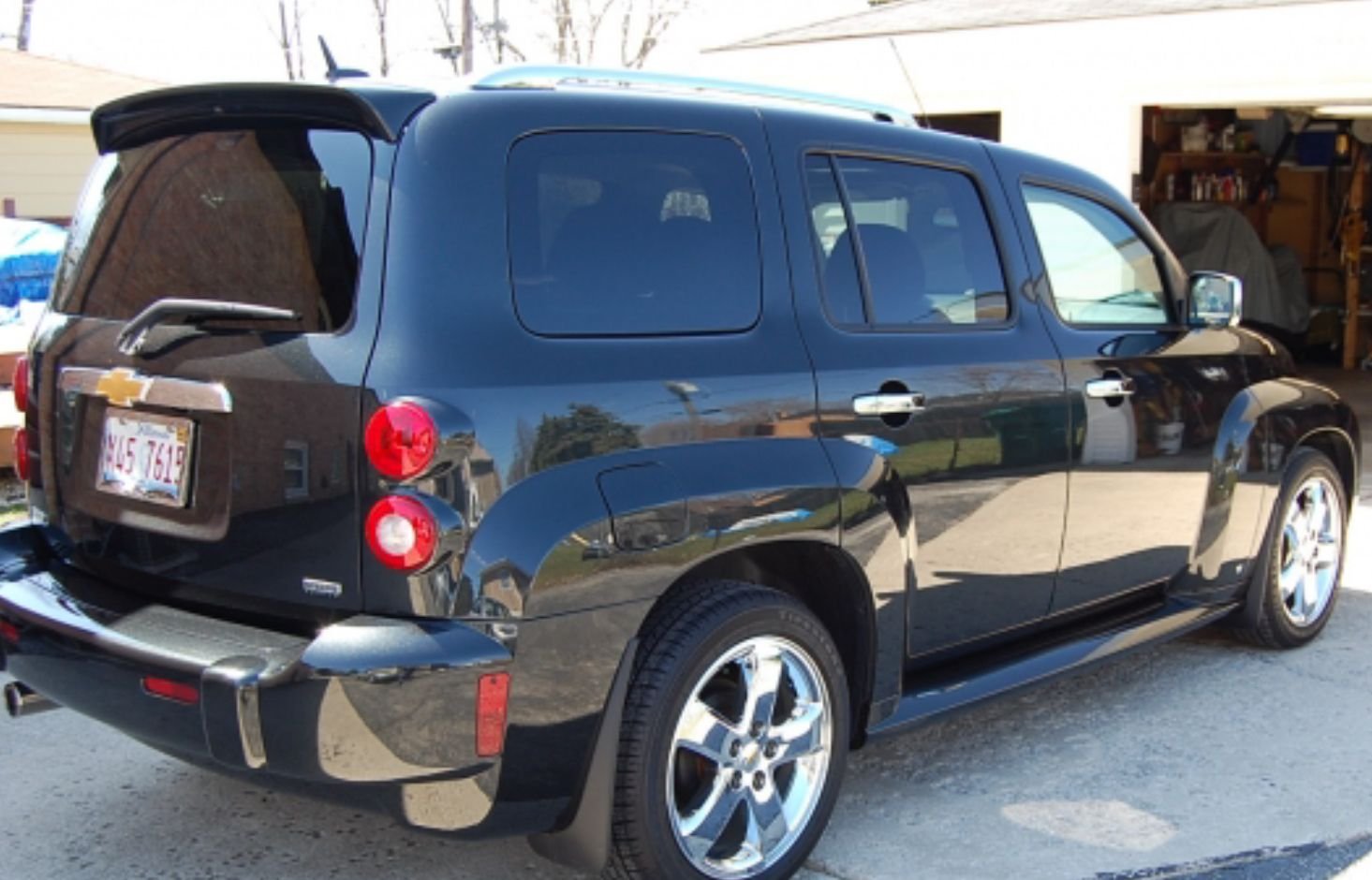

Careful. There was a 2008 "Shadow Edition" that reads black but is a metallic. Other than that, black is the same every year.
I would save the window regulator from your 2010 if it's good, as they sometimes fail. Pretty easy to take out. Maybe the window too. Maybe the mirror, too. And the 2008 might have a different finish on the mirror cap.
(Pic lifted from https://www.chevyhhr.net/forums/gene...on-hhrs-20755/)
