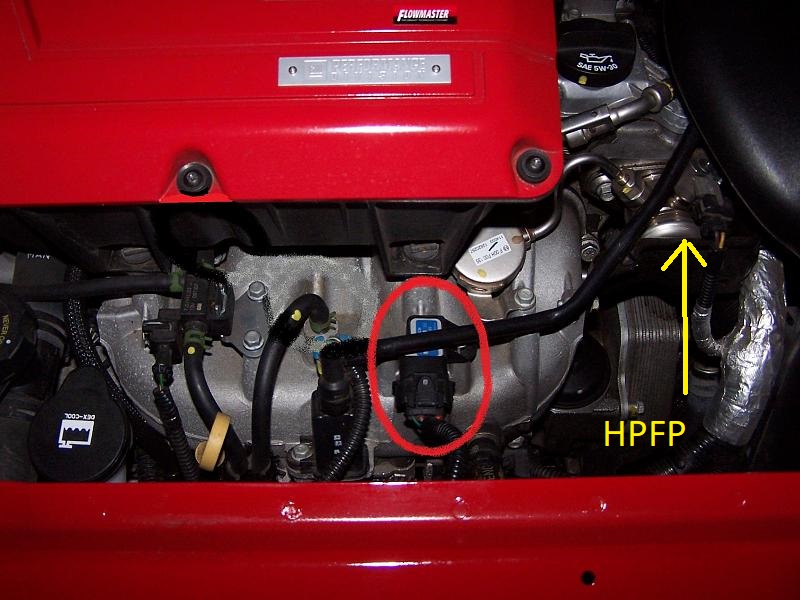

My guess would be the High Pressure Fuel Pump (HPFP). Use a mechanic’s stethoscope to find out where exactly the noise is.
Being this is a 2010 SS it will have the RPD gauge cluster. You could dial up the HPFP there and check the fuel pressure readings. Take a video of the RPD from a cold start to about 3 minutes.
High Pressure Fuel Pump should be covered with a noise deadening foam cover. (it's removed in this picture)
