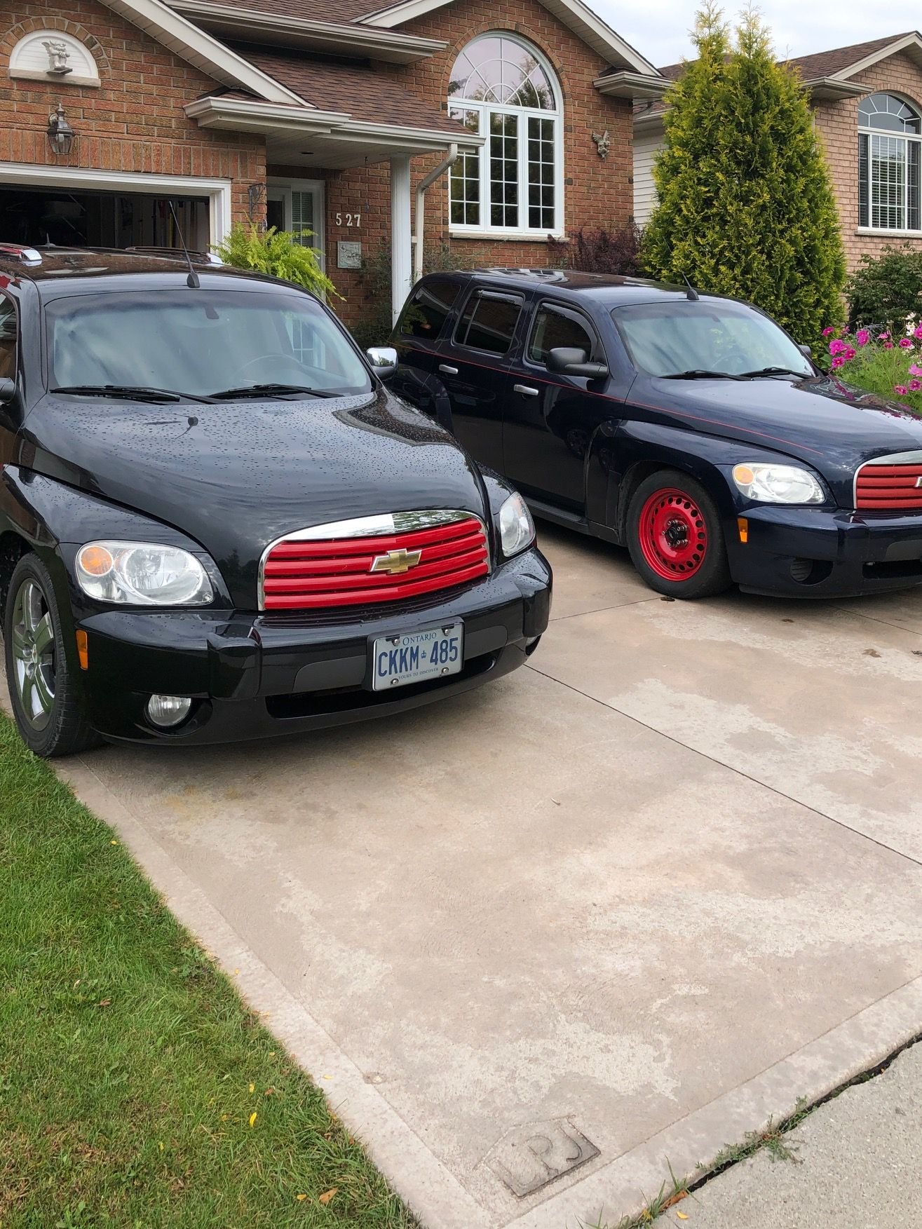

I owned Oldblue an LS with FE1 suspension, for ten years put on 400,000 klms , installed the KYB struts and shocks at 80,000 klms replaced those at 350,000 klms .
a smooth comfortable ride, I installed a set of KYB’s on my 2011 2LT replacing the OEM FE3 struts and shocks a very comfortable ride also.
The BlackSwan, 2011 2LT on the left and Oldblue, 2007 LS on the right
