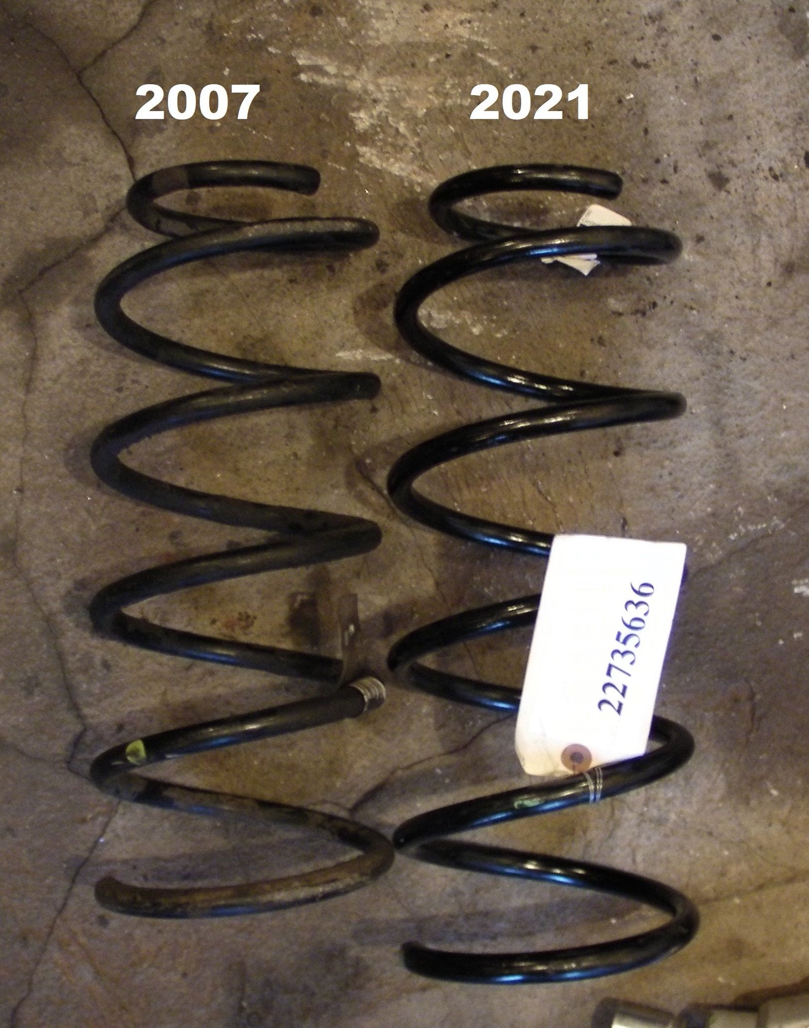

Here is the undeniable proof that springs sag/suffer from fatigue over time. 14 years old original spring to the left with 100 000 kilo of use. GM OEM spring replacement to the right.
I still wait for the rear springs replacement to be delivered.

We here KNOW that springs start to sag after years of use.
As does our body parts.
What being said is that the change in castor is very miniscule.
Remember ALL 4 springs have softened from 14 years of use.
As the springs soften so does the ride and when they are replaced the ride returns to original stiffness.

That’s the GM part number for the FE1 suspension.

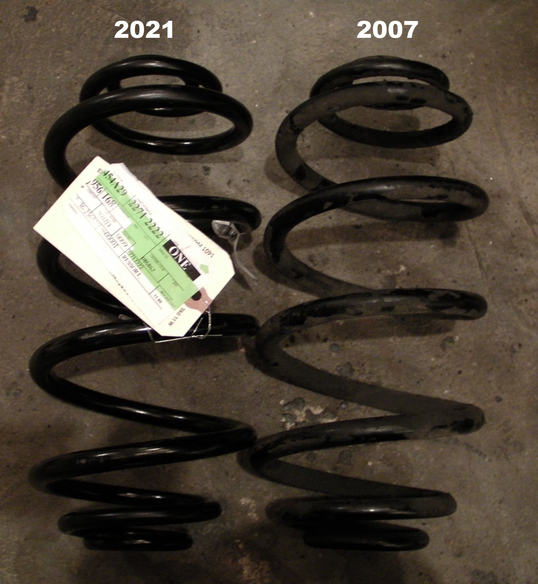

The rear springs look very alike if not the same. Although seemingly the same height - which surprised me a bit I thought the 2021 would be taller - the 2007 rear spring is easier to compress. After replacement the HHR is taller from the rear and the ride is much better. I will wait a couple of ride before giving my final opinion as to whether the ride is exactly the same as when I bought the HHR. It's much better now for sure.

I would say after 3 weeks and 2000 miles the springs have "break in" and are now operating at optimal comfort. The braking experience is very stable, the car sticks to the road and doesn't nose dive at all. I do not remember this stability from my other HHR, it's surprising. The ride feels smooth over road defects. It drives like a brand new car.
