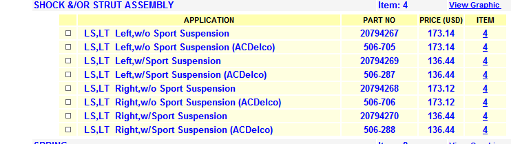

Shock absorbers HAVE NO EFFECT on ride height. However they need a longer travel if you increase the height WITH SPRINGS. Longer springs will increase bounce and sway.
Stop worrying about any difference between FE1 and FE3. If there is any difference it is in using old fashioned "Standard" shocks vs. "Premium" shocks. I don't think they make the different grades in gas shocks anymore.
You should be able to borrow or "buy and return" spring compressor at any auto parts store. Harbor freight has them for $32.99.
Bottom line is you are not going to get "the exact same" ride if you do anything to it. Raising it will make for sloppy handling and a tendency to roll over. If you want a high soft ride get a Escalade and let some air out of the tires..
Here are the front shock part numbers. All of the other suspension parts have the same part numbers (including rear shocks).
