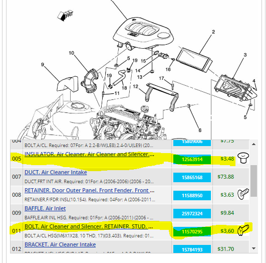

....this.
And the bolt that goes with it.
Thanks in advance.

Its just a grommet, no bolt, And nearly every HHR in history needs it LOL. My Gregg hasnt had it for as long as I have owned him.

Air Filter Box mounting Grommet - GM calls it an "Insulator"
- P/N - 12563914 (2.2L/2.4L)
- P/N - 25920906 (2.0L)
We have not recorded the part number for the bolt at this time.

The bolt is a stud that holds the grommet.
This one says all 3 are the same, some people have found the front one is different. There is a part listed for 2.0L (25920906) for the front insulator, but I don't know about that.

Well we have a part number
https://www.gmpartsdirect.com/oem-pa...-bolt-11570295

I think that is for SS. Goes with a clip.
