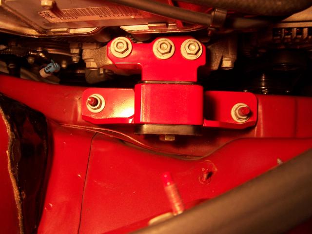

The mount that you will want to change, is the at the front of the engine and pretty easy to change. If you get one from TTR it will really tighten things up.

Yes. Very easy to change. Once you get the washer fluid reservoir out of the way, there is plenty of room to do the swap. Only 3 bolts, 2 nuts. Just have to have a jack under the engine to support it in place as you R&R the mount.
This pic shows the TTR front mount.
Name:  upper mount 2.jpg
