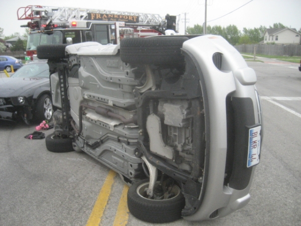

For those of you reading this and maybe hearing of the fuel line corrosion issues in rust belt states for the first time, here's a former member's HHR which ended up on its side after being rammed by a Mustang back in 2010.
The fuel lines run just in front of the left rear wheel, and it's a bit of a slush and mud trap there, so corrosive elements have all winter to "work" on the lines, so hitting the underside of your ride on above freezing days at a coin-op carwash is a good idea in snow country.
And don't worry, the member's wife was uninjured in this accident except for some bruises and jangled nerves.
